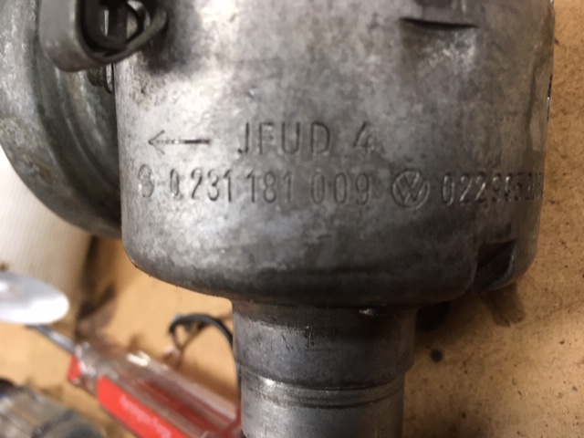

rbzymek
post Dec 13 2019, 11:47 AM
Posts: 201
Joined: 5-April 19
From: Northville, MI
Member No.: 23,013
FYI....
Gatornapper
post Dec 13 2019, 11:55 AM
Posts: 1,290
Joined: 22-September 17
From: Woods west of Richmond, VA
Member No.: 21,449
AH-HA!
It's a VW Part number!
The 0 231 178 009 has neither the VW nor the 022#............
GN
QUOTE(rbzymek @ Dec 13 2019, 12:47 PM) *
FYI....

rbzymek   So the 231 181 009 aka 022 905 205AA has a curve d...   Dec 13 2019, 10:52 AM
Gatornapper   I agree - research I have done confirms that.........   Dec 13 2019, 10:58 AM
Gatornapper   What I'd like to know is where does the 022 90...   Dec 13 2019, 11:03 AM
rbzymek   FYI....   Dec 13 2019, 11:47 AM
Gatornapper   AH-HA! It's a VW Part number! The 0 ...   Dec 13 2019, 11:55 AM
Gatornapper   Wondering if at this point we shouldn't move t...   Dec 13 2019, 12:28 PM
rbzymek   GN, That's the Bosch number 231 181 009. The V...   Dec 13 2019, 02:38 PM
Gatornapper   NOW it makes sense! Thank you! On the Pe...   Dec 13 2019, 06:59 PM
rbzymek   Here is a graph of the curve base on the Pelican t...   Dec 13 2019, 02:55 PM
