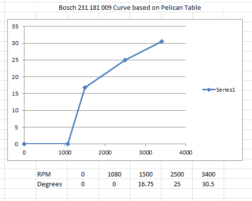

Here is a graph of the curve base on the Pelican table data for the VW 022 905 205AA aka Bosch 231 181 009

rbzymek   Here is a graph of the curve base on the Pelican t...   Dec 13 2019, 02:55 PM
