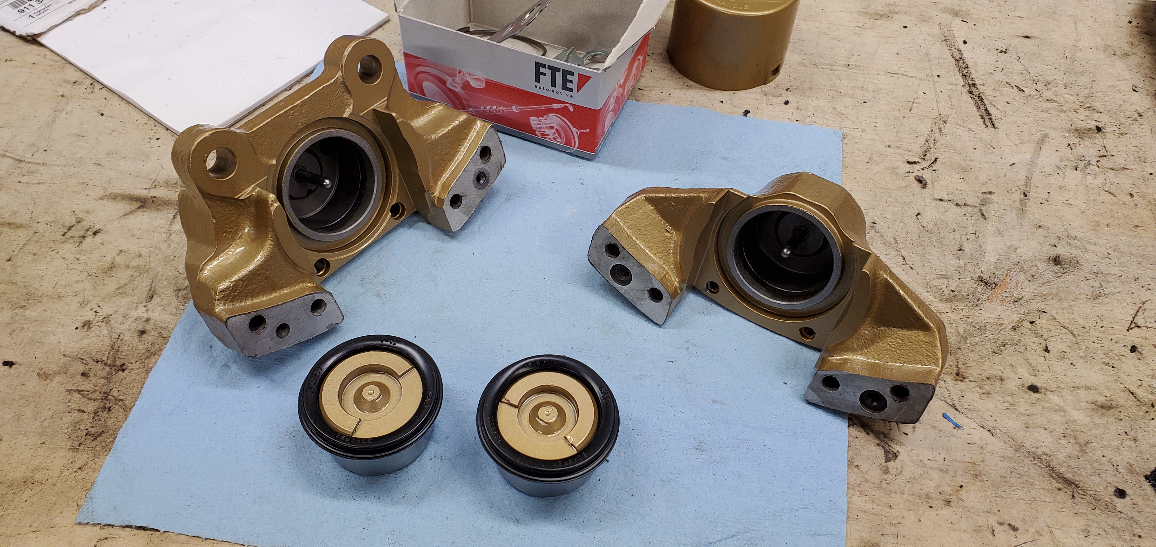

Making slow progress on the front rebuild.
Rebuild kit for calipers did not come with the little O-Rings that seal the 2 halves.
My local hardware store has lots of miscellaneous O-rings so hopefully I can find something that works.Attached Image

We have a line of viton O rings we make under contract for another company we have the ability sell them as it's another industry. Let me know what you need.
Mark
