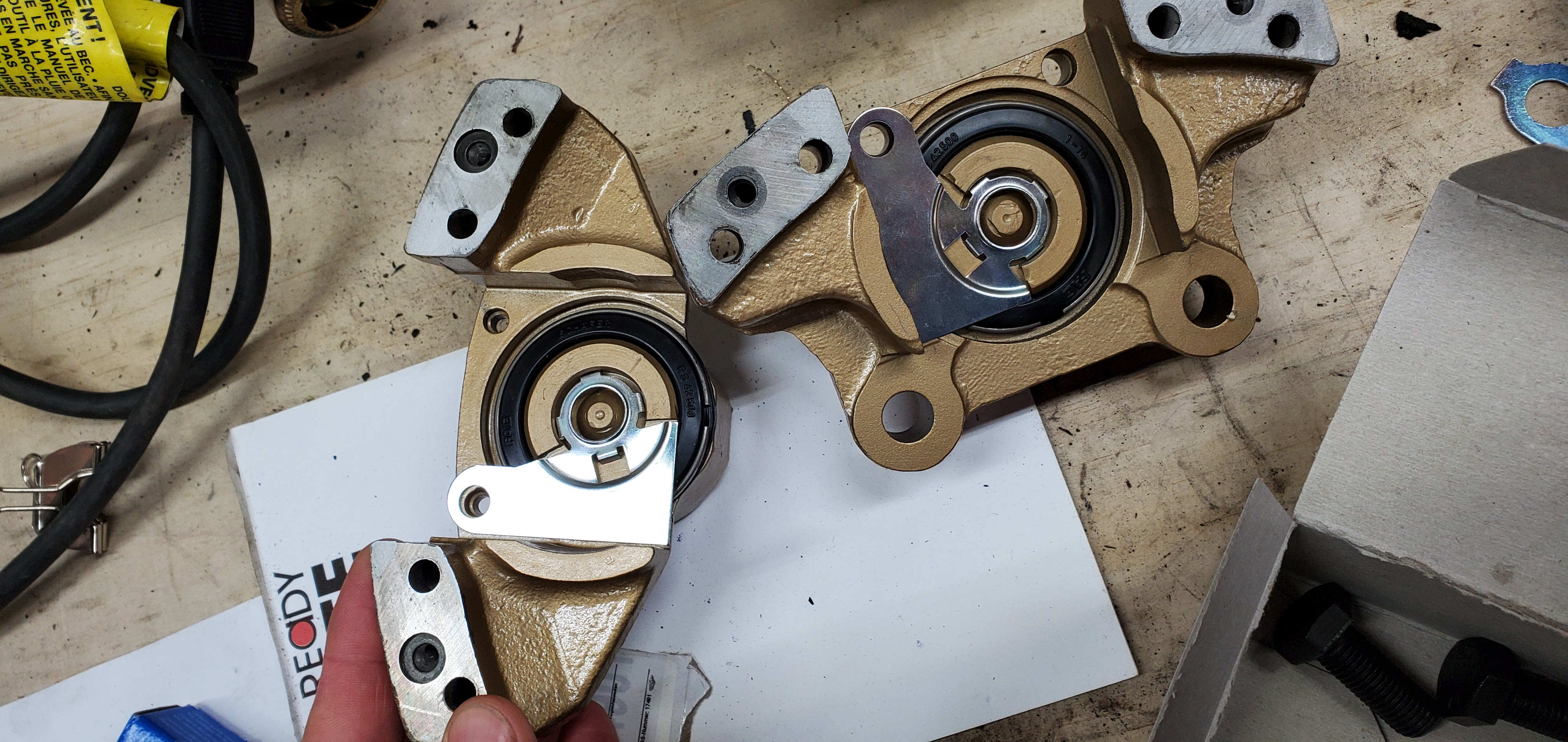

Can someone educate me on the "brake piston gauge plates"?
I took a 50/50 guess as to the orientation....is there a correct up and down or I guess should it be right or left? The piston could rotate 180 and go either way...?? (I'm sure if there is a wrong way that's what I did!)

maf914   Very nice looking work! Make sure the O-rings...   Dec 19 2019, 07:16 AM

bbrock   Thanks [b]@[url=http://www.914world.com/bbs2/ind...   Dec 20 2019, 12:50 AM
rgalla9146   If doing both calipers at the same time be sure to...   Dec 20 2019, 07:23 AM
tvdinnerbythepool   Thanks guys, trying to wrap my mind around it. Fou...   Dec 20 2019, 09:22 AM
