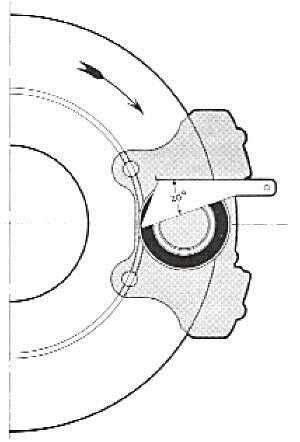

Thanks guys, trying to wrap my mind around it.
Found this pic on a 911 forum that I think helps tooAttached Image

tvdinnerbythepool   Making slow progress on the front rebuild. Rebui...   Dec 18 2019, 10:34 PM
Mikey914   Making slow progress on the front rebuild. Rebu...   Dec 19 2019, 01:50 PM
maf914   Very nice looking work! Make sure the O-rings...   Dec 19 2019, 07:16 AM
tvdinnerbythepool   Thanks @mikey914 text with specs sent Can someo...   Dec 19 2019, 08:16 PM
bbrock   Thanks [b]@[url=http://www.914world.com/bbs2/ind...   Dec 20 2019, 12:50 AM
rgalla9146   If doing both calipers at the same time be sure to...   Dec 20 2019, 07:23 AM
tvdinnerbythepool   Thanks guys, trying to wrap my mind around it. Fou...   Dec 20 2019, 09:22 AM
