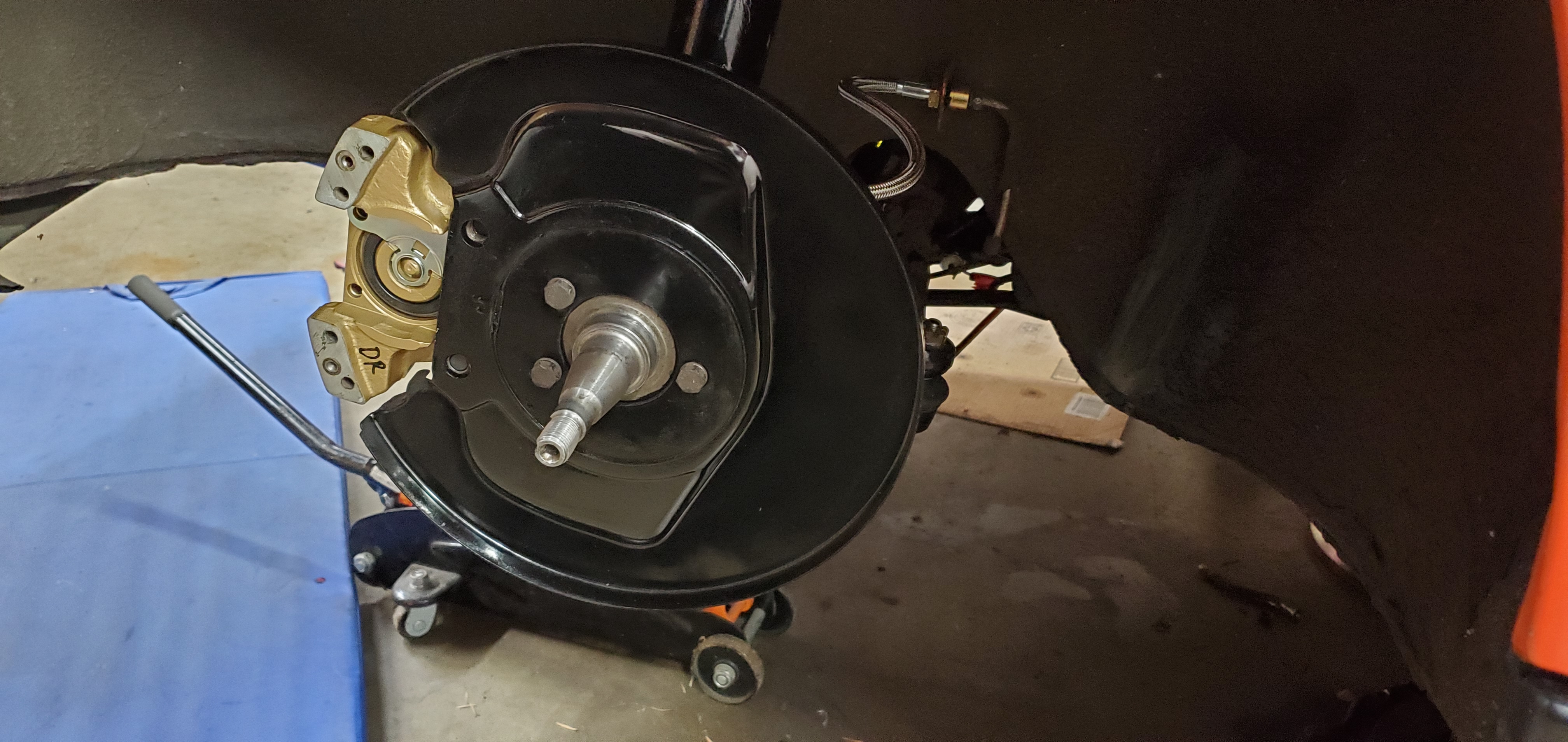

post Dec 21 2019, 02:39 PM
Posts: 310
Joined: 24-July 18
From: Olympia, WA
Member No.: 22,336
Did a test fit just to make sure I had it oriented right!Attached Image
