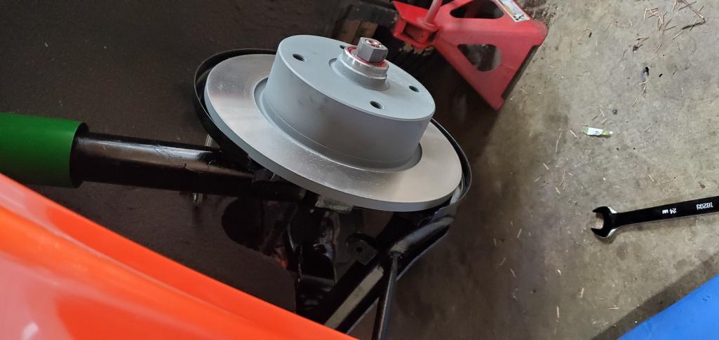

New discs and bearings are in!
Followed Ian's video for good measure.Attached Image
New Bilsteins, tie rod ends, ball joints, bushings, brake master cylinder, stainless lines, pads and lovely calipers will be on next once I get the o rings from 914rubber
