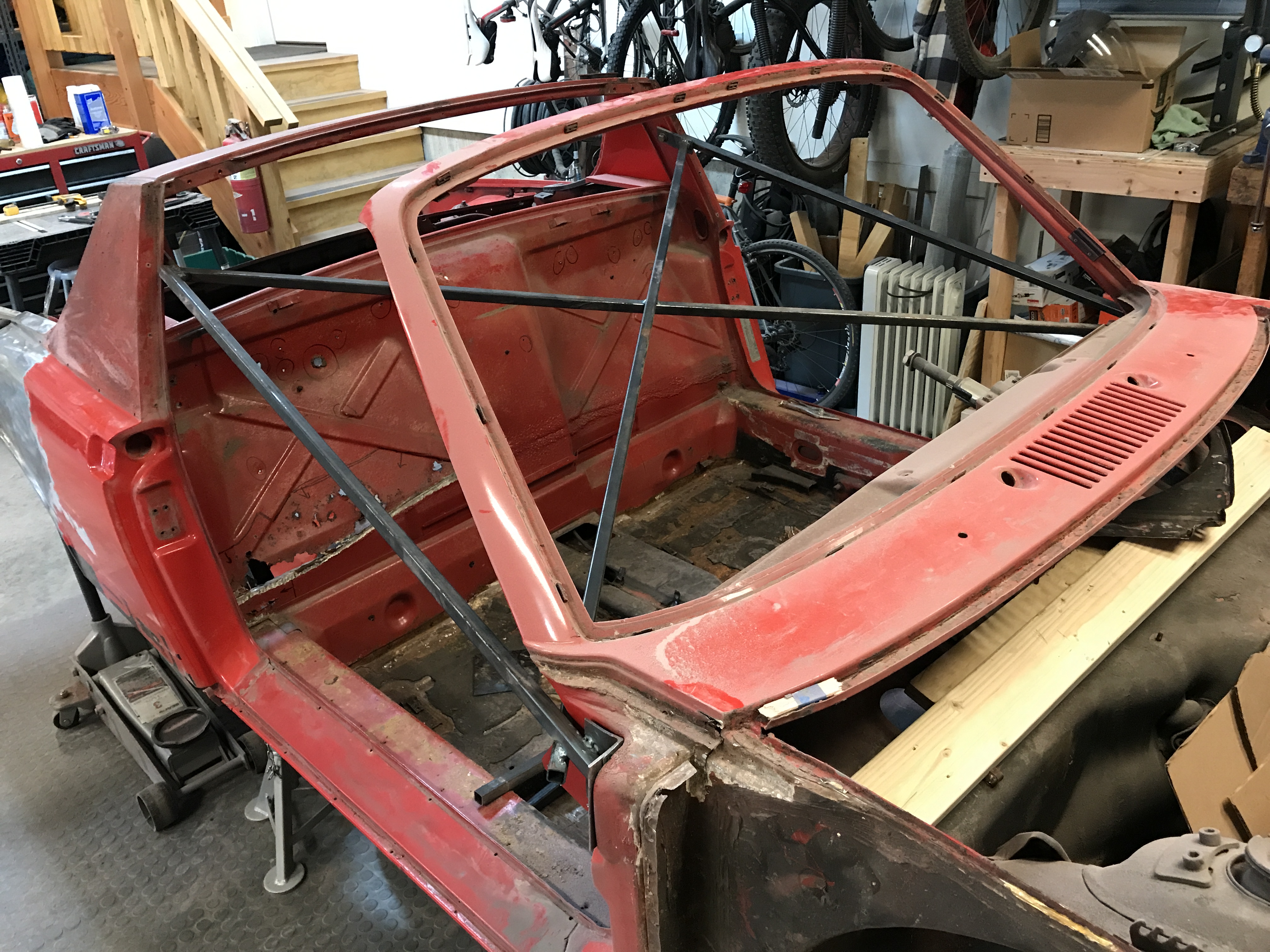

Completed the interior bracing with some diagonals. Not sure if necessary but my son was having fun with the new TIG welder.
