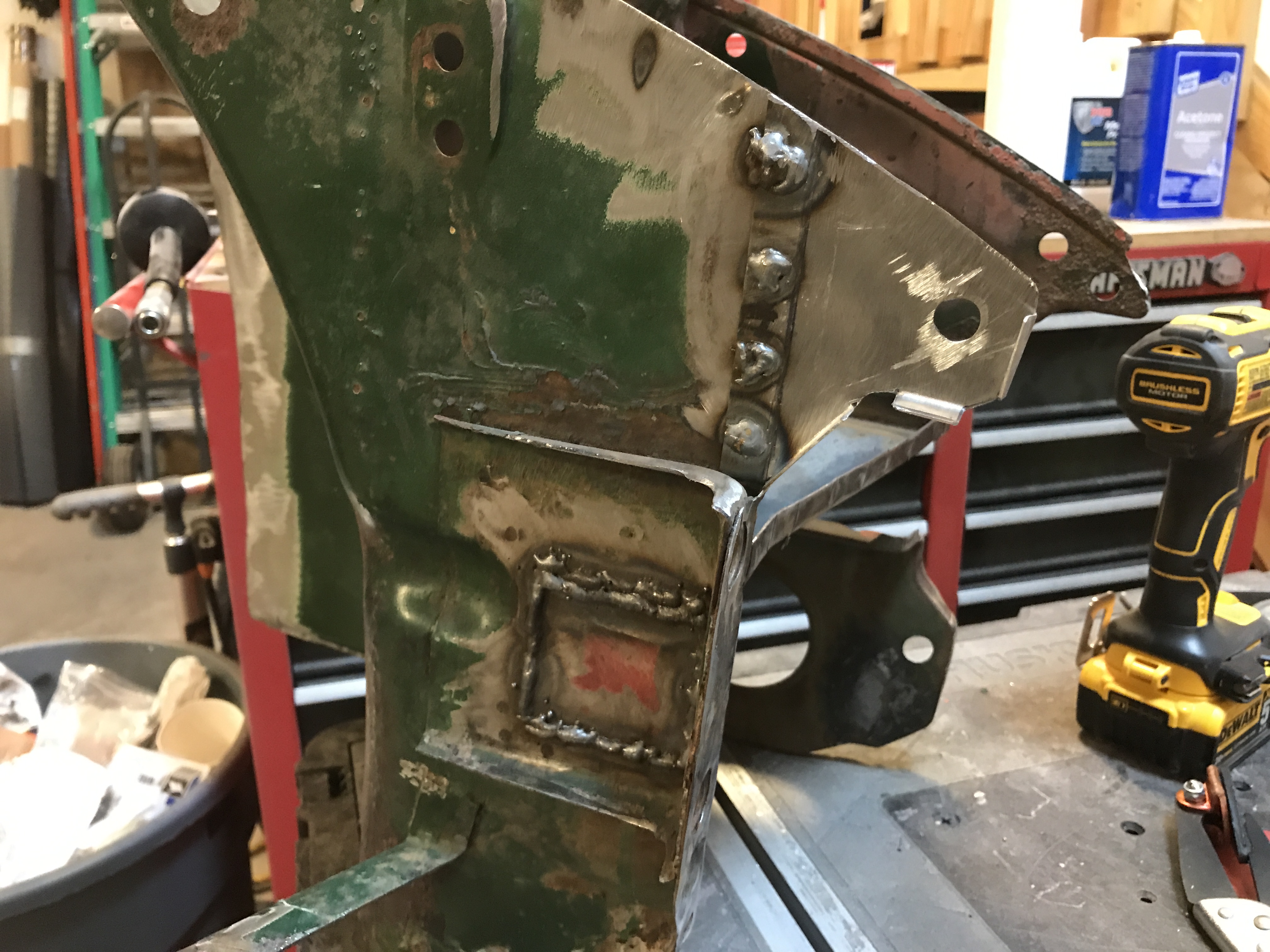

And completed the patches on the right front inner fender splice.

bkrantz   And completed the patches on the right front inner...   Dec 22 2019, 09:29 PM
