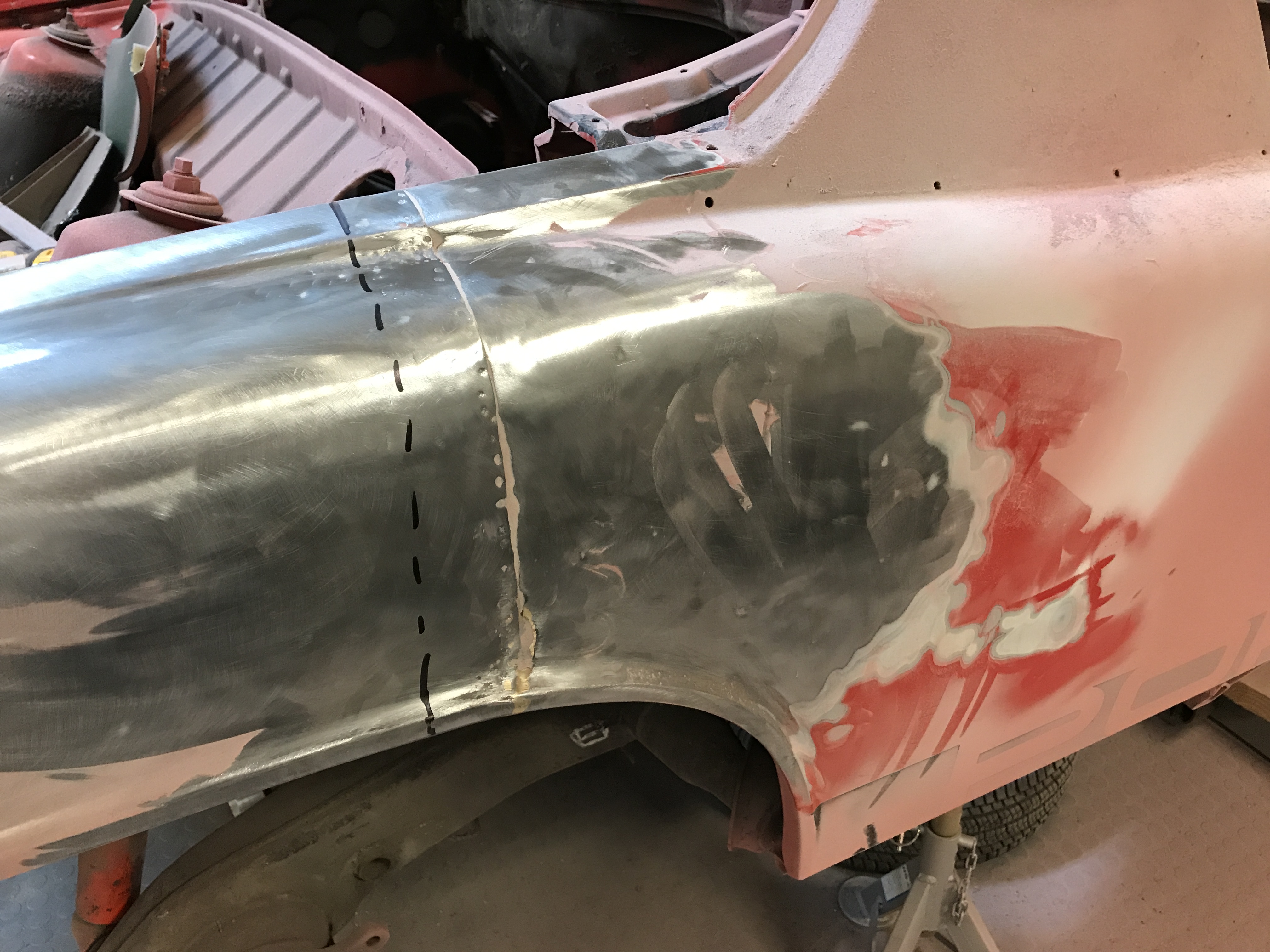

Two steps forward, at least one back!
I knew about this "surprise", with a crappy lap joint in the outer rear fender. I tried to ignore it for as long as possible, but decided to at least see how bad. Only attached on the outer lap with some spot welds and brazing.

bkrantz   Two steps forward, at least one back! I knew ...   Dec 22 2019, 09:32 PM
bkrantz   Decided to separate, in order to make it right. T...   Dec 22 2019, 09:35 PM
