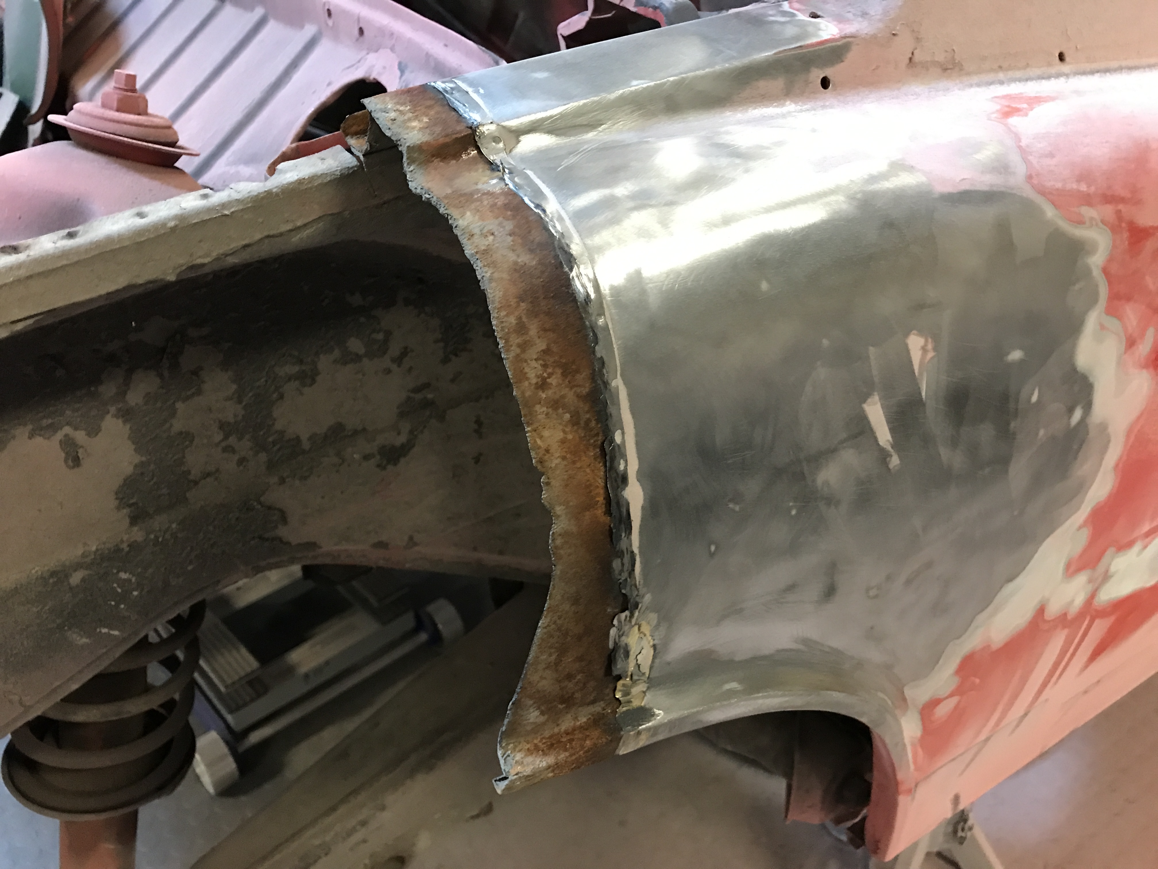

Decided to separate, in order to make it right. This also gives me better access to finish work on the inner fender. Pretty easy since the fender was only attached at the lap joint, some brazing around the tail light opening, and one spot of brazing on the top seam.
