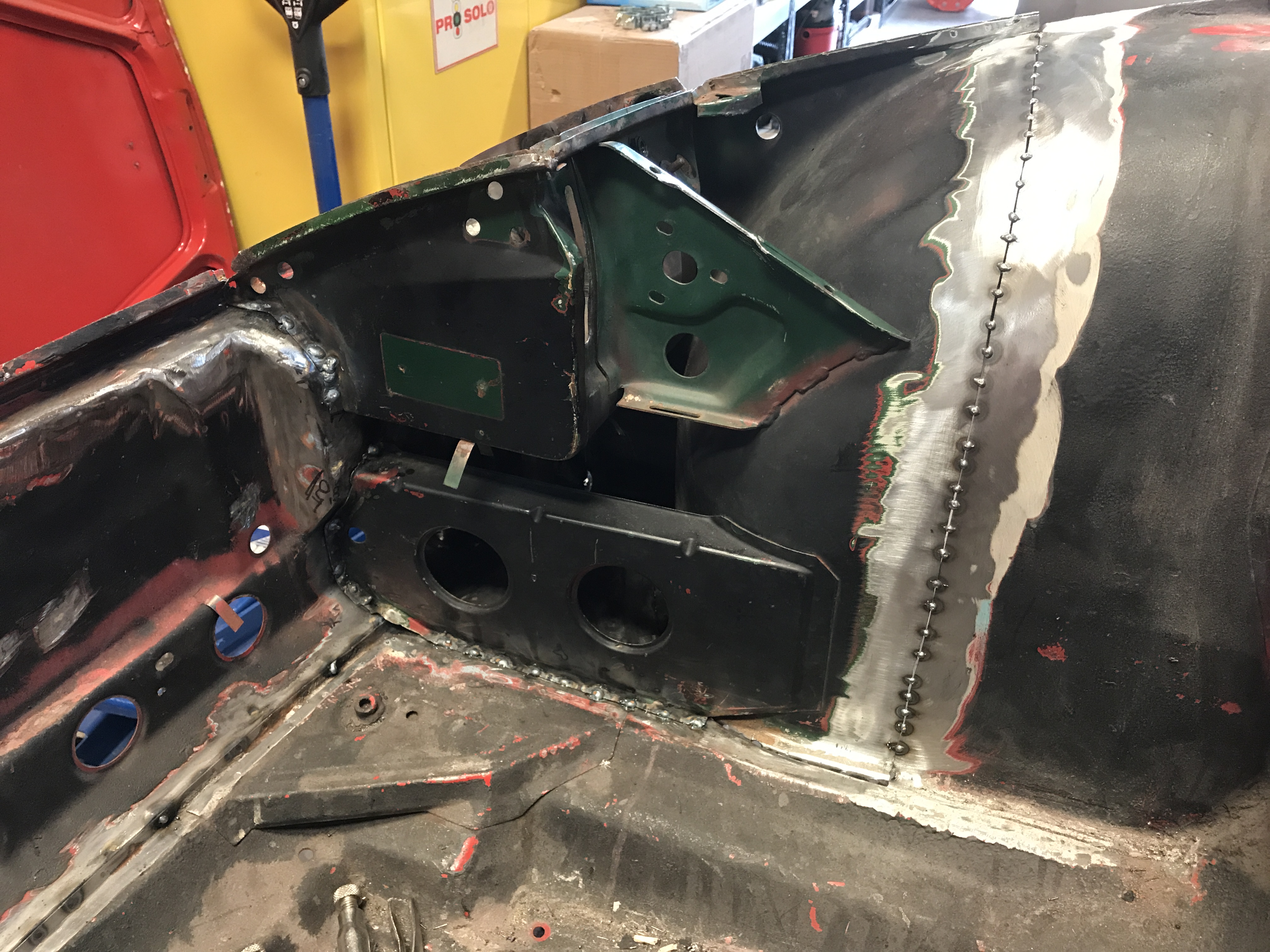

Member No.: 23,343
Here's the front corner mostly welded in place. A few more tweaks and we can finish the butt seam.

bkrantz   Here's the front corner mostly welded in place...   Dec 23 2019, 09:29 PM
