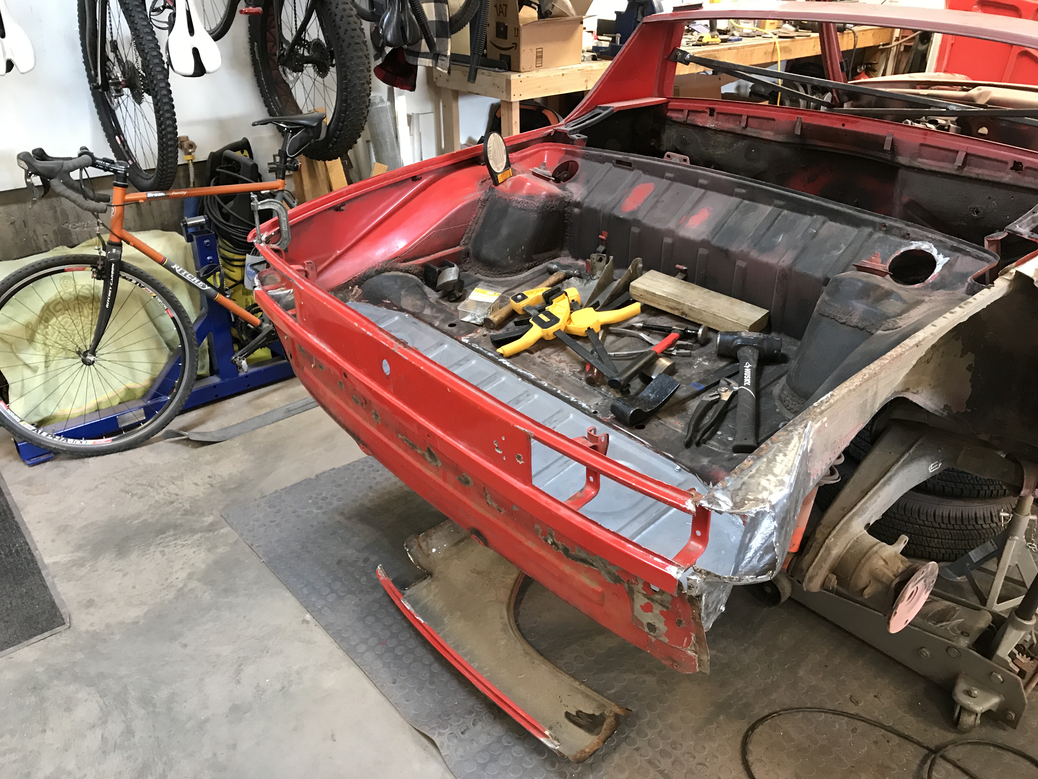

bkrantz   Meanwhile, getting started on the rear. First tri...   Dec 23 2019, 09:32 PM
bkrantz   And starting the fit for the rear panel. This wil...   Dec 23 2019, 09:34 PM
bkrantz   Right side is looking better, with access after re...   Dec 23 2019, 09:35 PM

bkrantz   Only a half-day for xmas, since I want to get as m...   Dec 25 2019, 09:16 PM
bkrantz   And a further adjustment and test fit for all the ...   Dec 25 2019, 09:21 PM

bkrantz   Got the rear panel and outer fender welds mostly d...   Dec 26 2019, 09:09 PM
bkrantz   Left side needed a 3/4 inch wide filler for the ga...   Dec 26 2019, 09:11 PM
bkrantz   Same on the right side, but the gap was only 3/16 ...   Dec 26 2019, 09:12 PM
