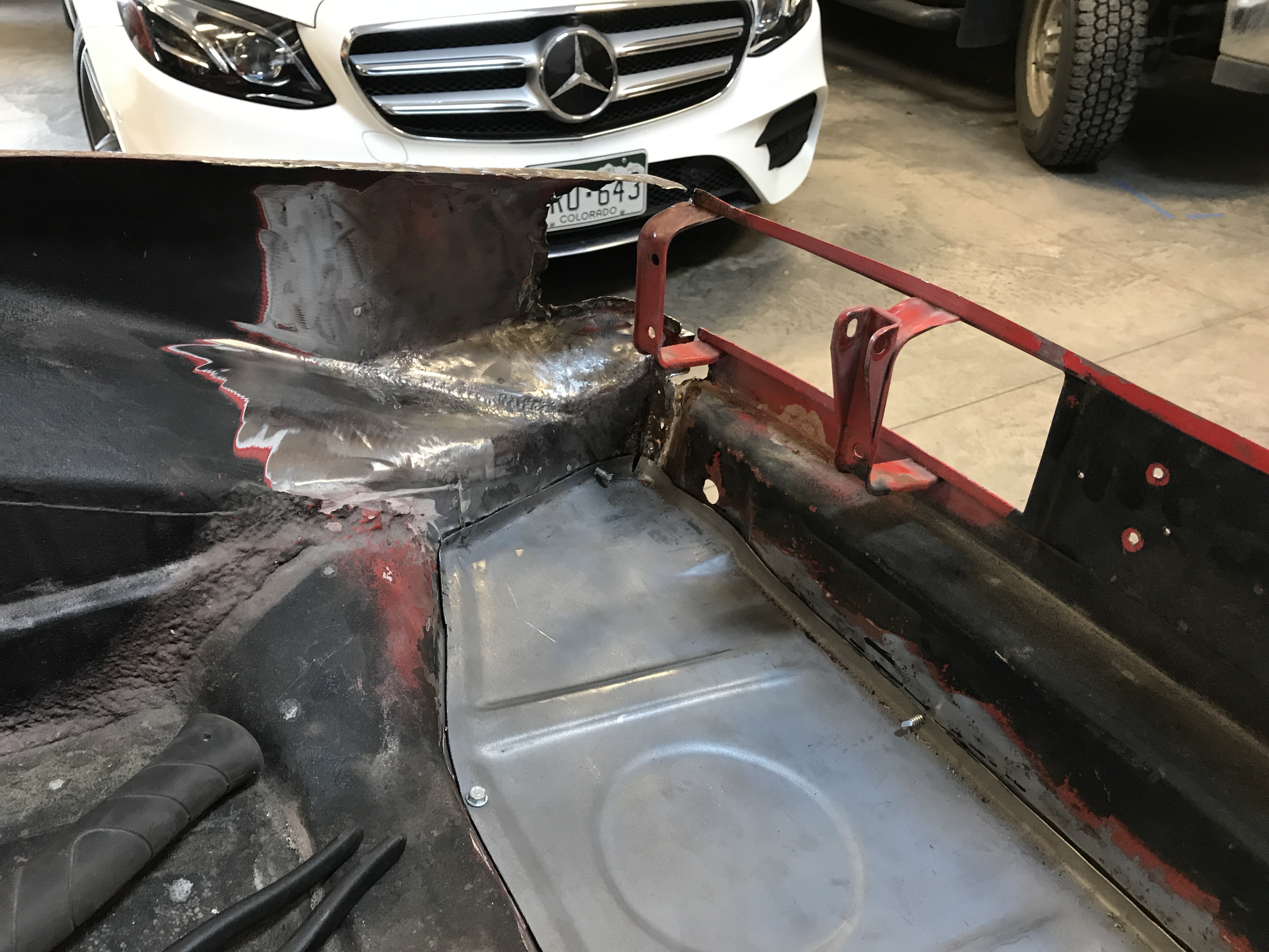

Member No.: 23,343
Right side is looking better, with access after removing the outer fender.
