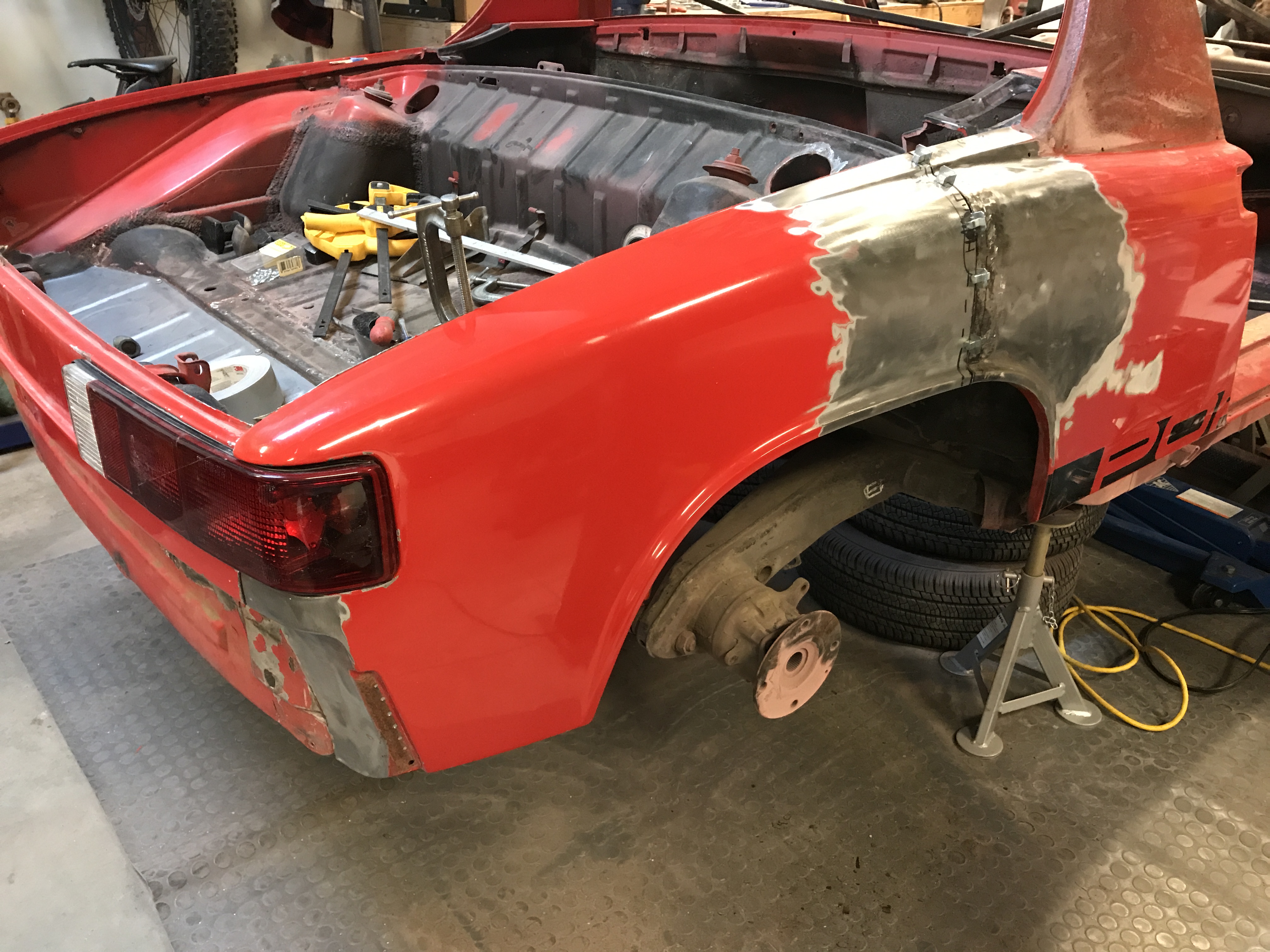

bkrantz   Here's the front corner mostly welded in place...   Dec 23 2019, 09:29 PM
bkrantz   Meanwhile, getting started on the rear. First tri...   Dec 23 2019, 09:32 PM
bkrantz   And starting the fit for the rear panel. This wil...   Dec 23 2019, 09:34 PM
bkrantz   Right side is looking better, with access after re...   Dec 23 2019, 09:35 PM

bkrantz   Got the outer fender cut and fit. A few more twea...   Dec 24 2019, 09:58 PM
bkrantz   And...here's the last dodgy previous repair, w...   Dec 24 2019, 10:00 PM

bkrantz   Got the rear panel and outer fender welds mostly d...   Dec 26 2019, 09:09 PM
bkrantz   Left side needed a 3/4 inch wide filler for the ga...   Dec 26 2019, 09:11 PM
bkrantz   Same on the right side, but the gap was only 3/16 ...   Dec 26 2019, 09:12 PM
bkrantz   And what was the lap joint in the front panel, now...   Dec 26 2019, 09:14 PM
