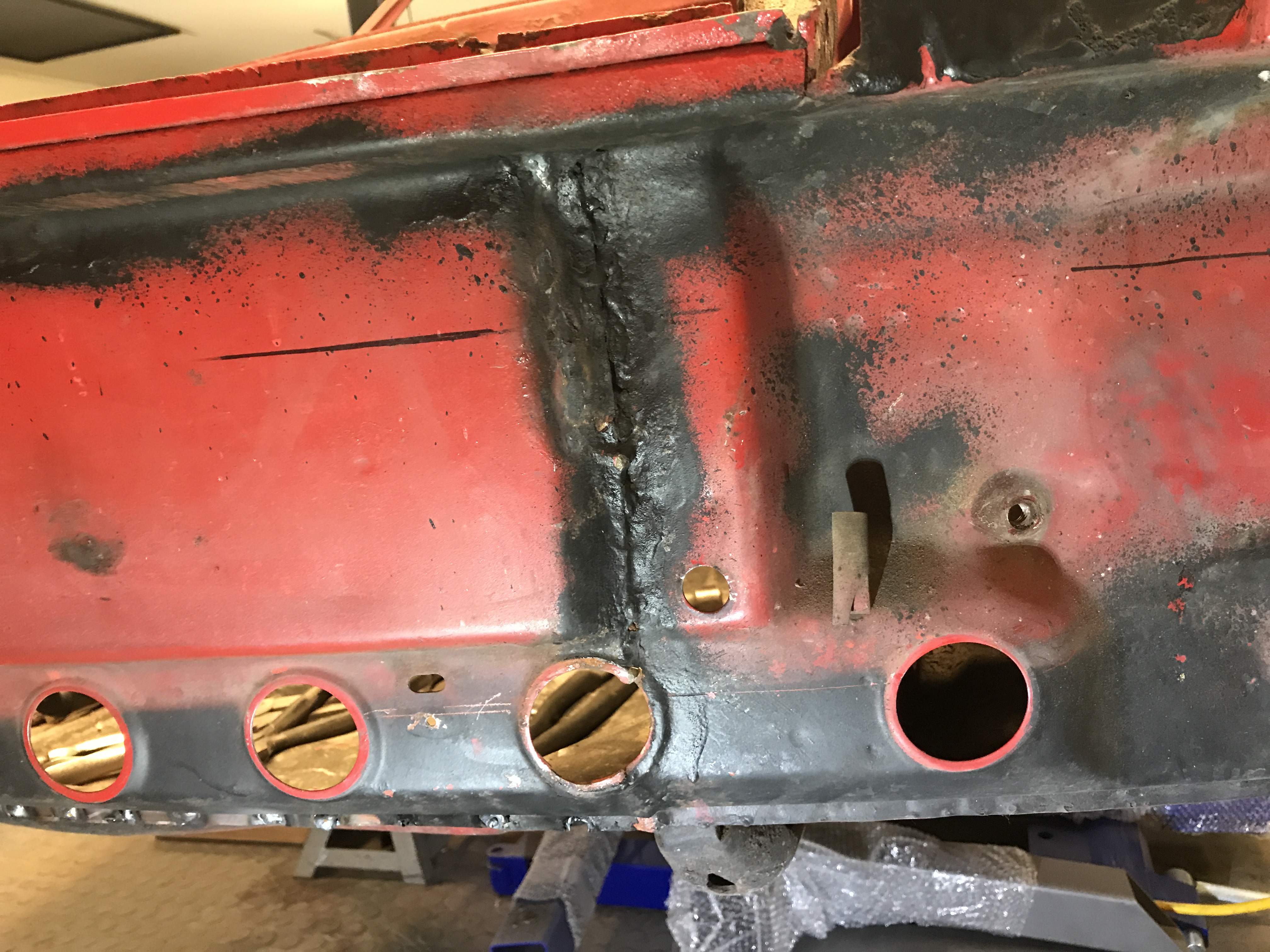

And...here's the last dodgy previous repair, where somebody spliced a replacement front panel with a lap joint, just inside of the left head light. Time to fix this.

bkrantz   And...here's the last dodgy previous repair, w...   Dec 24 2019, 10:00 PM

bkrantz   And what was the lap joint in the front panel, now...   Dec 26 2019, 09:14 PM

bkrantz   Getting the front seam stitched up, along with the...   Dec 27 2019, 09:52 PM
