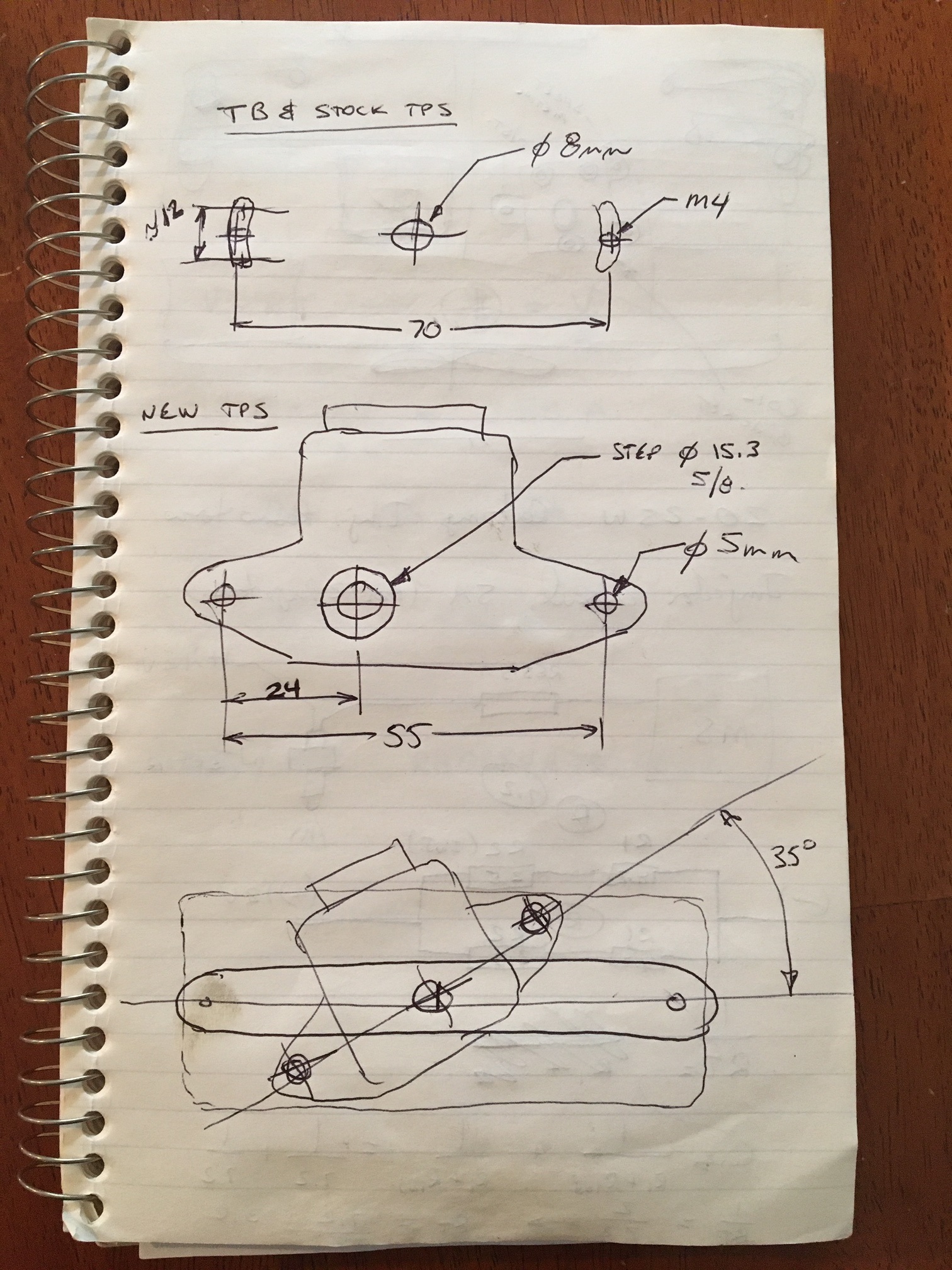

Personal design notes on the TPS bracket design. (IMG:style_emoticons/default/santa_smiley.gif)

Montreal914   Moving on to the TPS bracket. As mentioned before,...   Dec 22 2019, 03:31 PM
Superhawk996   I started taking measurement and designing the b...   Dec 22 2019, 04:23 PM
Montreal914   Here is a snapshot of my Excel spreadsheet. I obvi...   Dec 22 2019, 03:40 PM
