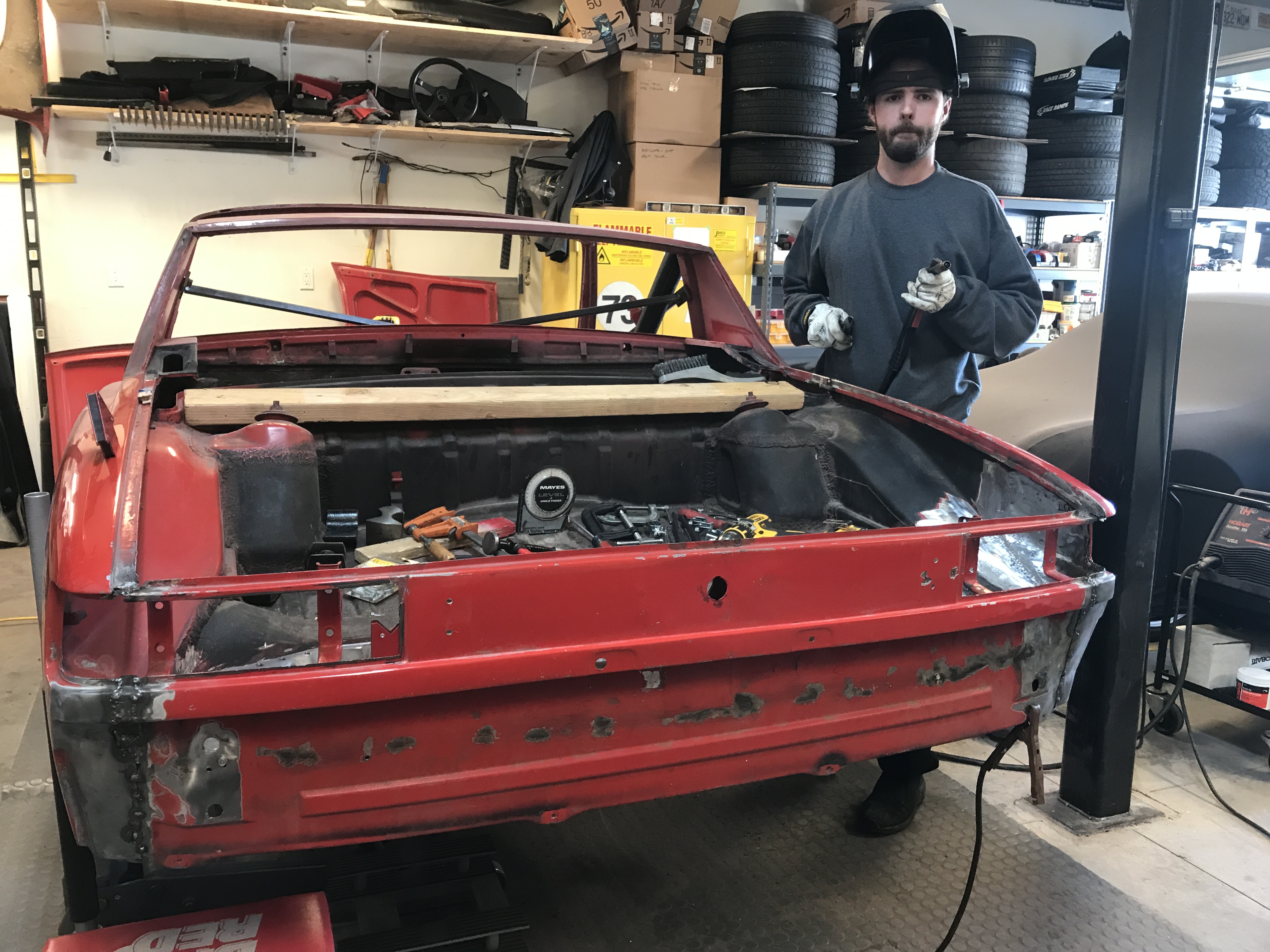

Thanks. So far, none of the previous repairs meet even my lowest standard. And the lap joint in the rear fender was truly awful, with a jagged, irregular cut along the underlying edge (and nothing to even pretend sealing that inner joint).
Definitely learning as we go, and enjoying having my son do most of the welding.

bkrantz   Got the rear panel and outer fender welds mostly d...   Dec 26 2019, 09:09 PM
bkrantz   Left side needed a 3/4 inch wide filler for the ga...   Dec 26 2019, 09:11 PM
bkrantz   Same on the right side, but the gap was only 3/16 ...   Dec 26 2019, 09:12 PM
bkrantz   And what was the lap joint in the front panel, now...   Dec 26 2019, 09:14 PM
