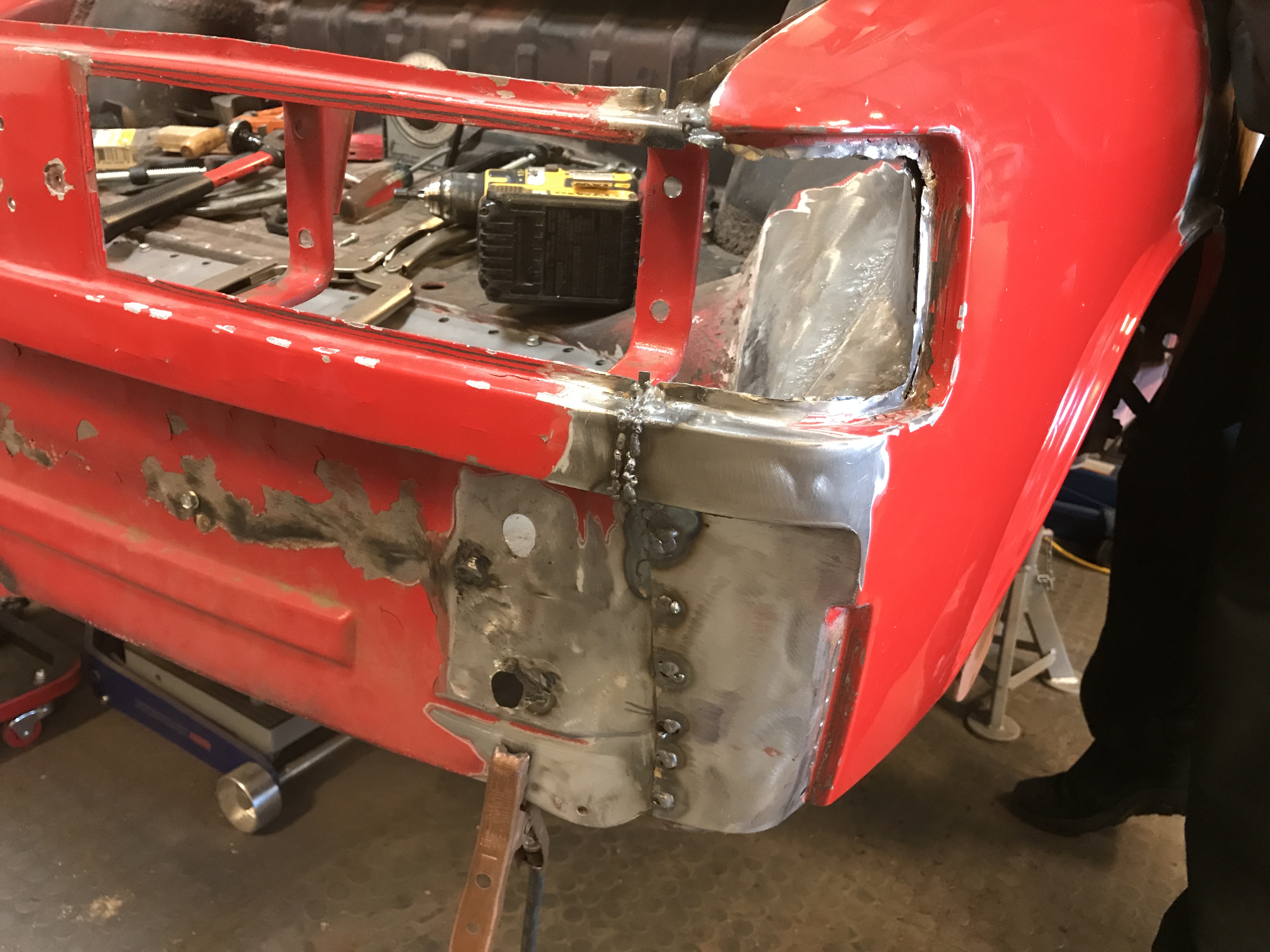

bkrantz   Got the rear panel and outer fender welds mostly d...   Dec 26 2019, 09:09 PM
bkrantz   Left side needed a 3/4 inch wide filler for the ga...   Dec 26 2019, 09:11 PM
bkrantz   Same on the right side, but the gap was only 3/16 ...   Dec 26 2019, 09:12 PM
bkrantz   And what was the lap joint in the front panel, now...   Dec 26 2019, 09:14 PM
