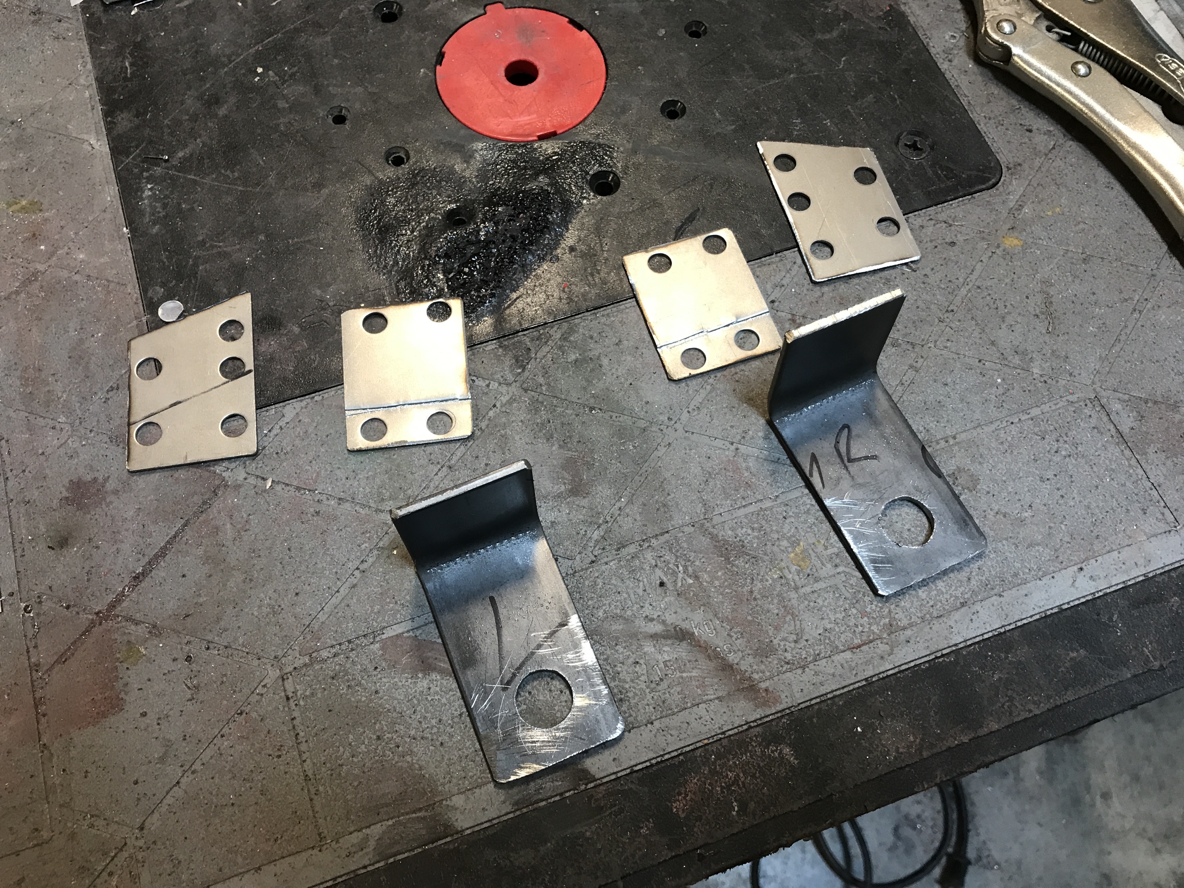

Here are the accessory pieces I made for the rear: heavy gauge L-brackets for the bumper mounting holes below the floor, light gauge reinforcements for the holes above the floor, and reinforcing patches for the floor above the rear sway bar brackets.

Bob - you are doing everything right.
It was nice to see the progress in person Friday.
Keep up the great work and let me know if you need another set of hands after your son leaves.
