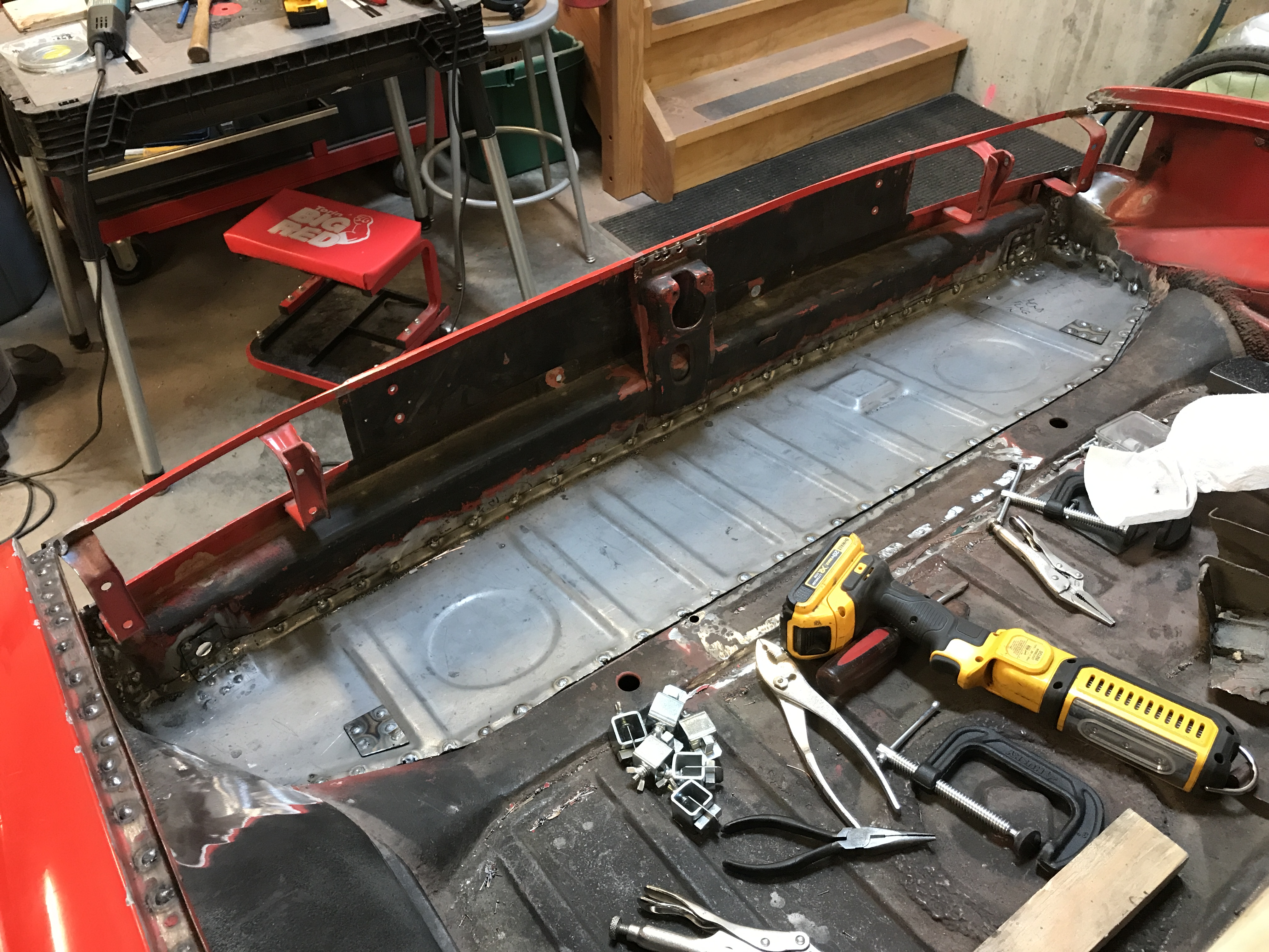

Got the trunk floor welded in, with plug welds all around, and some creative thick beads in the rear corners (these will get ground down).

bkrantz   Got the trunk floor welded in, with plug welds all...   Dec 28 2019, 09:48 PM
