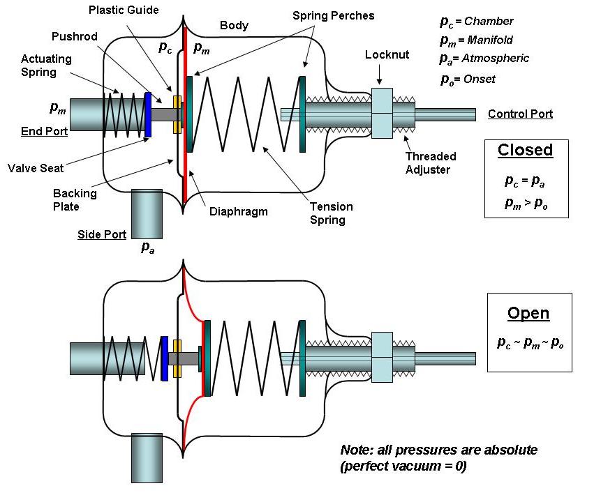

GregAmy   It doesn't "control the vacuum" (if ...   Jan 3 2020, 07:10 AM

GregAmy   OK, so if it's an L-Jet like Mark says, and th...   Jan 3 2020, 12:42 PM

Mark Henry   Ian has a '74 Ljet, complete system and dizzy ...   Jan 3 2020, 01:11 PM
