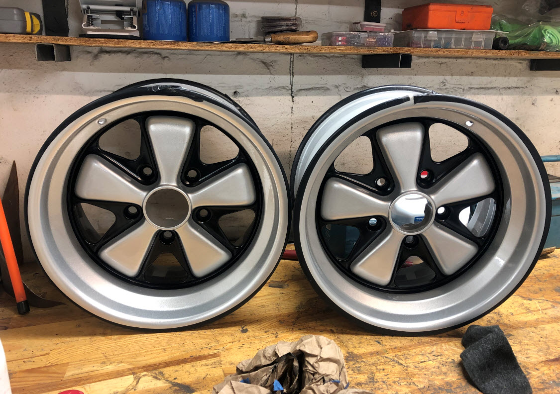

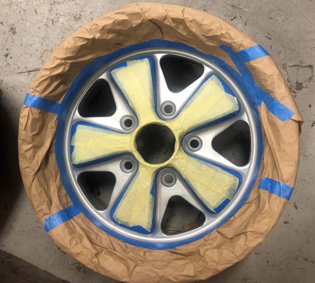

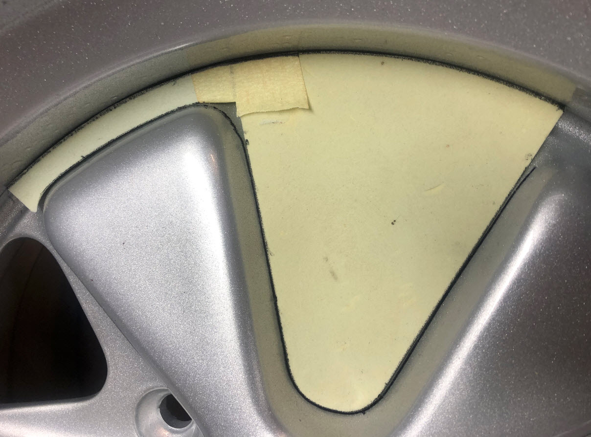

Fuchs Friday.

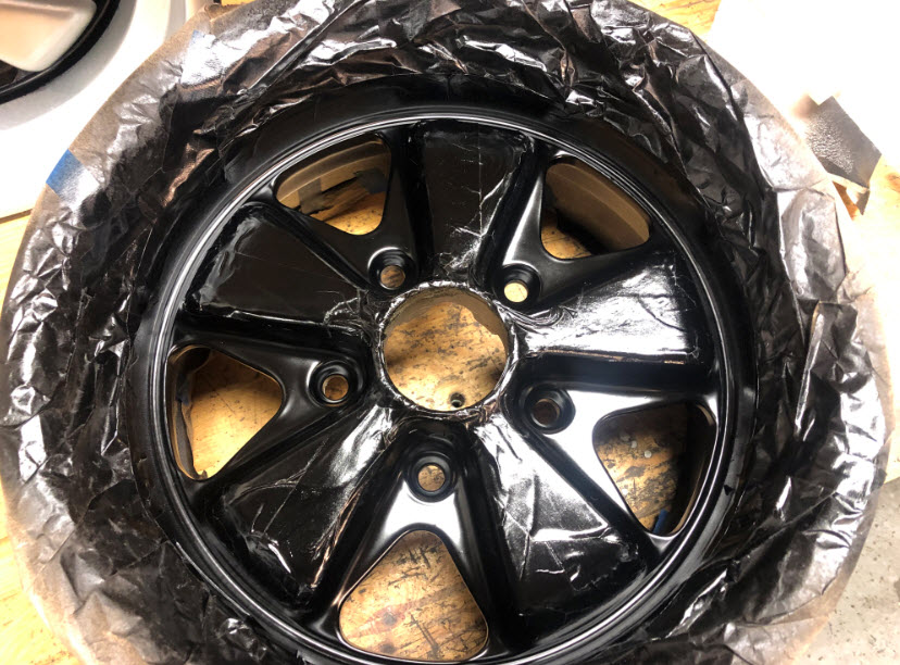

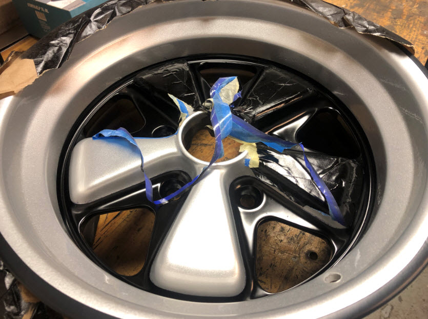

bought some 8x15 fuchs wheels some time ago. They were painted and had some pitting, but otherwice guite nice. I got them stripped and powder painted in the same finish as the rear 9x15 minilites. They were not possible to restore "properly" with anodized surface bechause of the pitting. I did the black detailing myself.

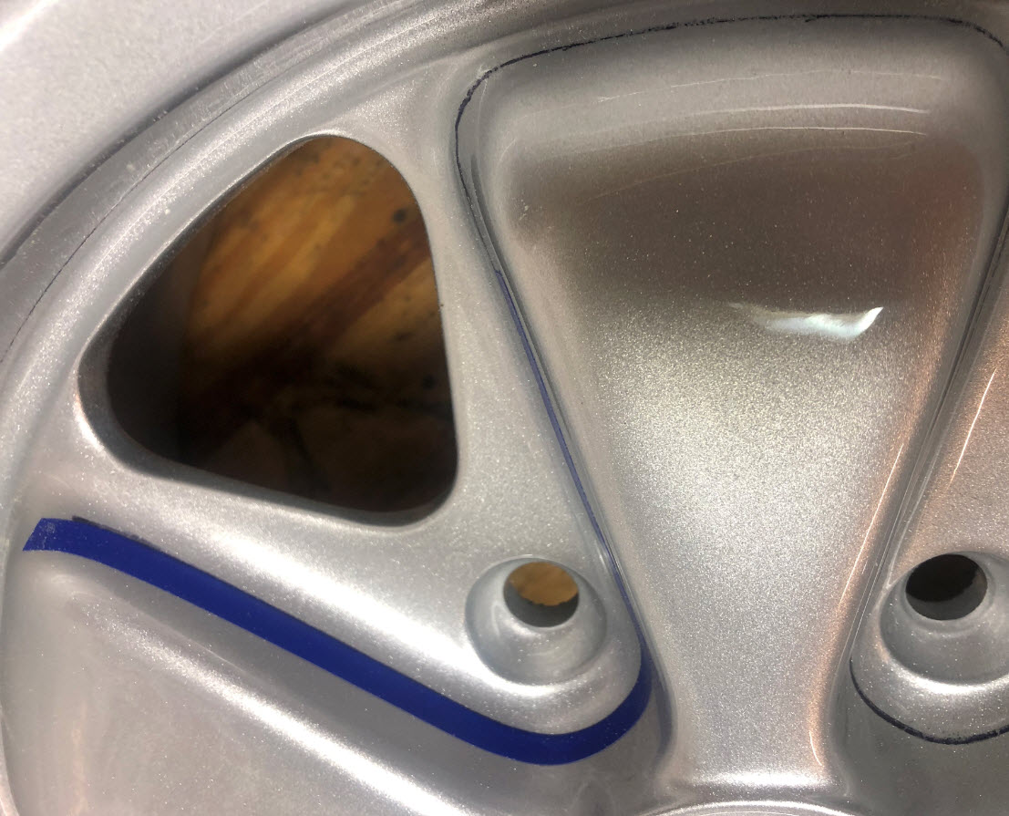

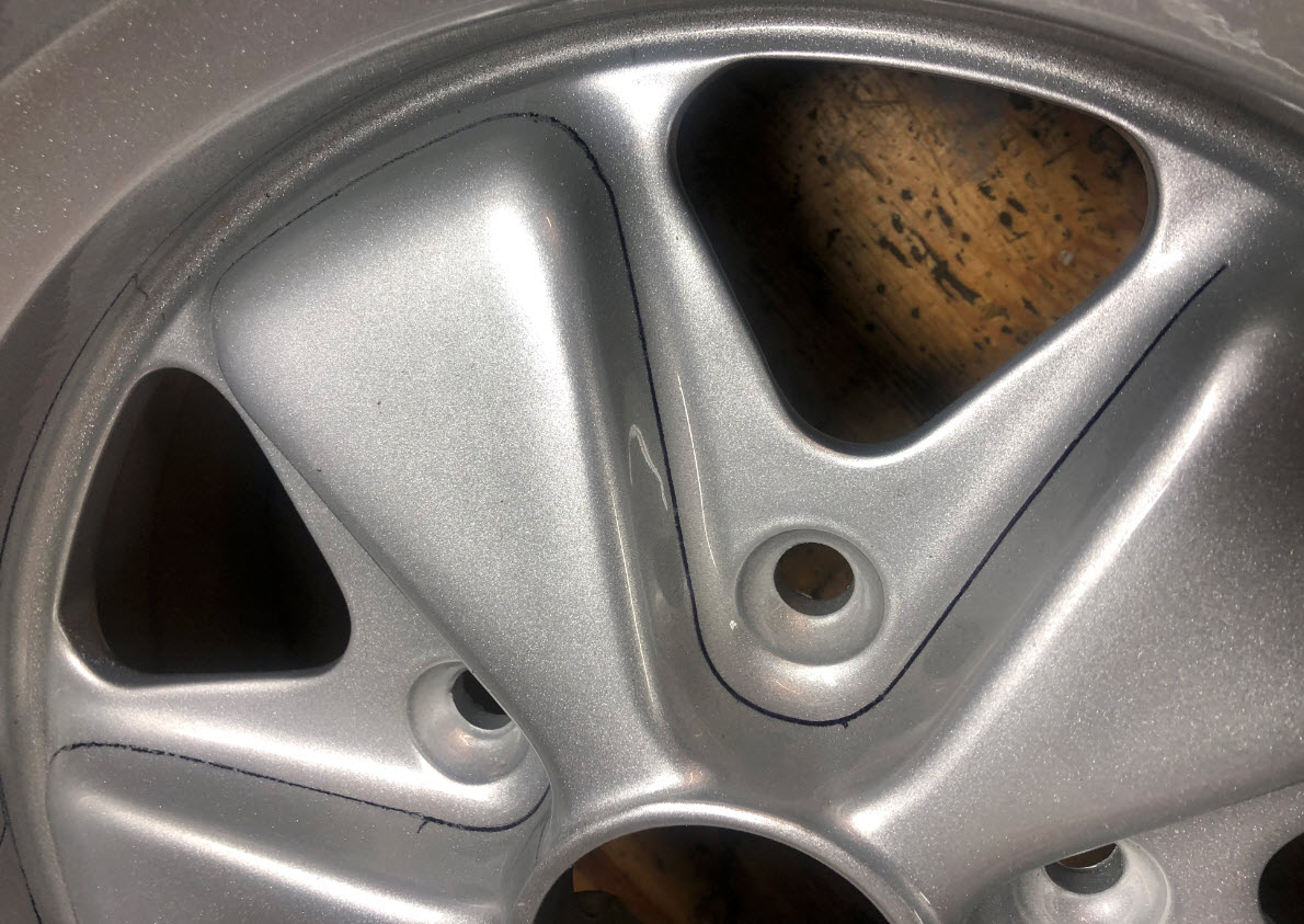

Started doing the masking by hand, but was not sucessfull (IMG:style_emoticons/default/hissyfit.gif) , so I made a part I could draw a help line with.
Line
Then I used thin masking tape and followed the line.
And some more masking..
And painted with 2K satin black.
Exciting moment
Glad it was only two though.

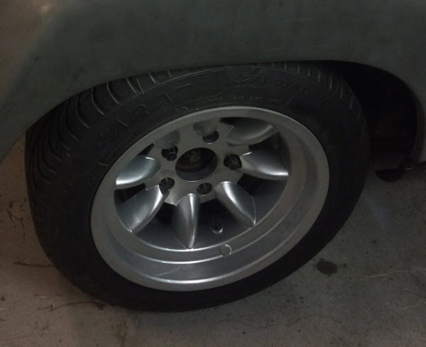

The rear Minilites
