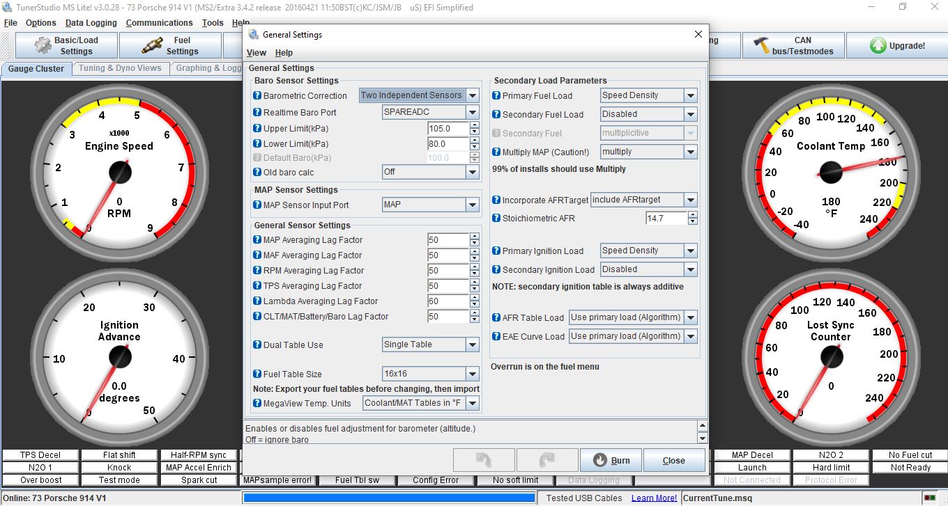

QUOTE(JamesM @ Dec 31 2019, 09:24 AM) *
QUOTE(Montreal914 @ Dec 30 2019, 10:04 PM) *
I guess I will connect this one to the analog input of the system but haven't looked yet. Hopefully, there will be a selection for this MAP sensor. (IMG:style_emoticons/default/confused24.gif)
vref and gnd connect to the same wires as your 1st MAP sensor. The signal wire on the 2nd sensor can connect to various inputs depending on what firmware you run. I have been using the "spareADC" port for this. Just be sure whatever you wire it to you then match in your tunerstudio config.
@JamesM , thank you for the input. Here is a screenshot of my ATM pressure MAP setup. Let me know if you see anything that seems wrong. It wouldn't be surprising... (IMG:style_emoticons/default/rolleyes.gif)
