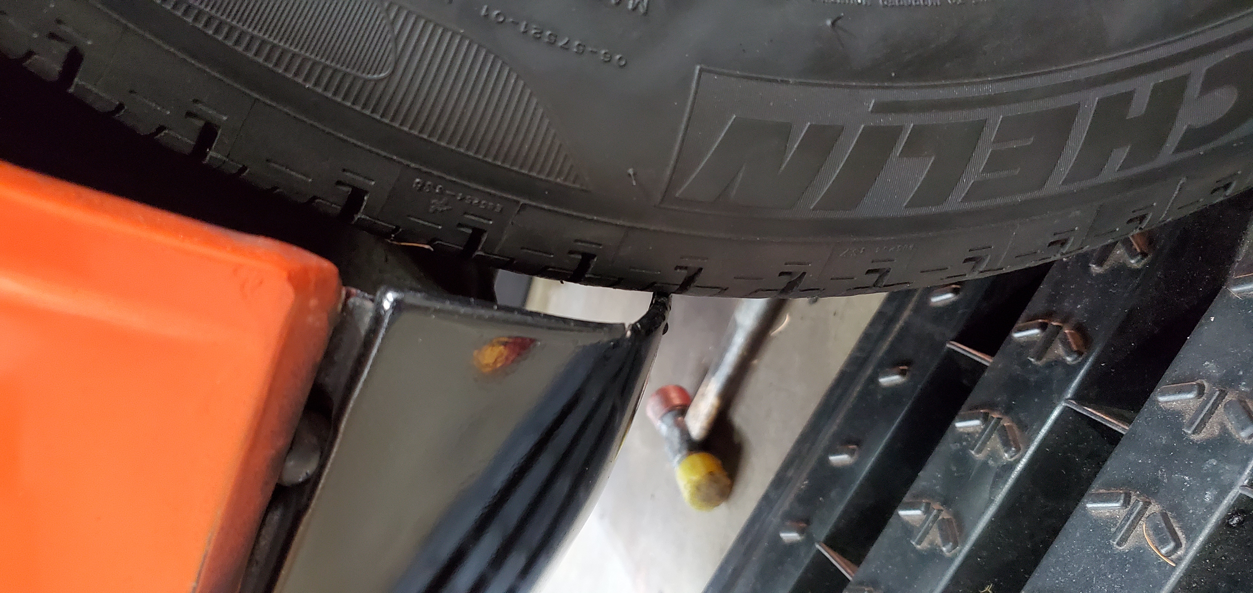

This car is like the most frustrating game of Whack a Mole! Fix one problem and boom there's another. (IMG:style_emoticons/default/hissyfit.gif) (IMG:style_emoticons/default/hissyfit.gif) (IMG:style_emoticons/default/hissyfit.gif) (IMG:style_emoticons/default/hissyfit.gif)
So, suspension, brakes, everything is in rebuilt and pretty! Today's project was to set the front ride height. I followed the procedure, Floor to Center Hub - 90 and that's the height to the center of the torsion bar. A pain in the ass going in circles but I think I finally got it pretty dialed in.
The issue is: now the front is raised up to the correct height the tire strikes the front valance when I turn the wheel hardly at all. I couldn't get the car out of the driveway.
I did not have the issue pre-rebuild, however, pre-rebuild the car was slammed with tons of camber.
My guess is, like the many issues these have brought me, it's the wheel/tire combo.
Rivieras with 195-60R15. I think they are just too damn wide and too tall. The PO messed with so much stuff on this car to make these stupid tires fit.
What do you guys think? Am I missing anything else??
I can't afford wheels and tires after all the cash that went into this so far so i'm limited to just tires.

DickSteinkamp   What do you guys think? Am I missing anything e...   Jan 5 2020, 07:44 PM
ndfrigi   with 195x60 tires, it should not be that close to ...   Jan 5 2020, 07:23 PM
mepstein   It’s the Rivs. That’s a wide tire for them but...   Jan 5 2020, 07:41 PM
tvdinnerbythepool   Here is a side view pic. The ride height is too hi...   Jan 5 2020, 08:14 PM
ndfrigi   Here is a side view pic. The ride height is too h...   Jan 5 2020, 09:37 PM
raynekat   Here is a side view pic. The ride height is too ...   Jan 5 2020, 09:45 PM
tvdinnerbythepool   RE: Suspension and Brake Refresh   Jan 5 2020, 08:15 PM
rhodyguy   Have you settled the suspension? You need to roll ...   Jan 5 2020, 08:19 PM
tvdinnerbythepool   Have you settled the suspension? You need to roll...   Jan 5 2020, 08:25 PM
mepstein   The type of wheel won’t make a difference. They ...   Jan 5 2020, 08:25 PM
burton73   The type of wheel won’t make a difference. They...   Jan 5 2020, 09:14 PM
