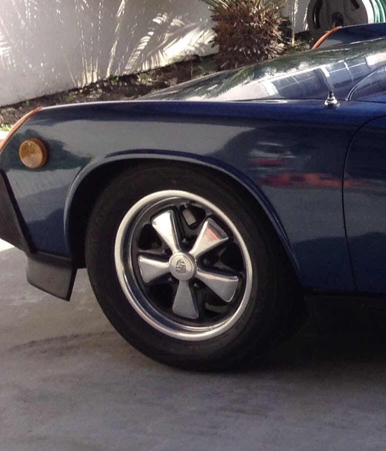

with 195x60 tires, it should not be that close to the front fender lip/valance. Any picture of the whole tire seeing the whole fender distance? or pic of the rear side of that tire to the fender?
below is 205x60 tire on 15x6 fuch wheel.

tvdinnerbythepool   This car is like the most frustrating game of Whac...   Jan 5 2020, 06:44 PM
DickSteinkamp   What do you guys think? Am I missing anything e...   Jan 5 2020, 07:44 PM
ndfrigi   with 195x60 tires, it should not be that close to ...   Jan 5 2020, 07:23 PM
mepstein   It’s the Rivs. That’s a wide tire for them but...   Jan 5 2020, 07:41 PM
tvdinnerbythepool   Here is a side view pic. The ride height is too hi...   Jan 5 2020, 08:14 PM
ndfrigi   Here is a side view pic. The ride height is too h...   Jan 5 2020, 09:37 PM
raynekat   Here is a side view pic. The ride height is too ...   Jan 5 2020, 09:45 PM
tvdinnerbythepool   RE: Suspension and Brake Refresh   Jan 5 2020, 08:15 PM
rhodyguy   Have you settled the suspension? You need to roll ...   Jan 5 2020, 08:19 PM
tvdinnerbythepool   Have you settled the suspension? You need to roll...   Jan 5 2020, 08:25 PM
mepstein   The type of wheel won’t make a difference. They ...   Jan 5 2020, 08:25 PM
