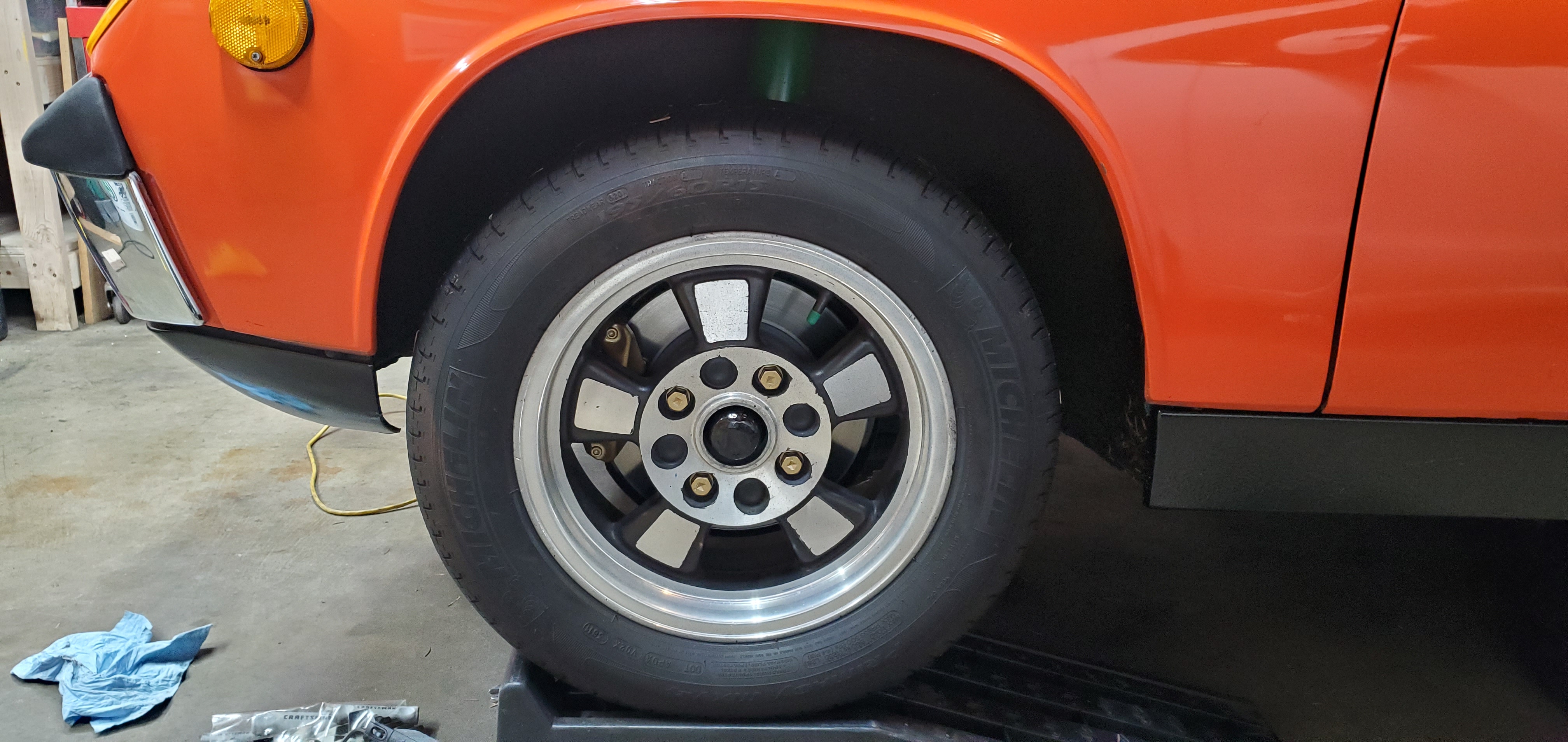

Here is a side view pic. The ride height is too high and the back of the car is on jack stands making it look even worse, however, I don't think this is my issue. I believe it is the stock valance.
I'm also now thinking the formula for front ride height is not working with the rivieras...ugh

tvdinnerbythepool   This car is like the most frustrating game of Whac...   Jan 5 2020, 06:44 PM
DickSteinkamp   What do you guys think? Am I missing anything e...   Jan 5 2020, 07:44 PM
ndfrigi   with 195x60 tires, it should not be that close to ...   Jan 5 2020, 07:23 PM
mepstein   It’s the Rivs. That’s a wide tire for them but...   Jan 5 2020, 07:41 PM
tvdinnerbythepool   Here is a side view pic. The ride height is too hi...   Jan 5 2020, 08:14 PM
ndfrigi   Here is a side view pic. The ride height is too h...   Jan 5 2020, 09:37 PM
raynekat   Here is a side view pic. The ride height is too ...   Jan 5 2020, 09:45 PM
tvdinnerbythepool   RE: Suspension and Brake Refresh   Jan 5 2020, 08:15 PM
rhodyguy   Have you settled the suspension? You need to roll ...   Jan 5 2020, 08:19 PM
tvdinnerbythepool   Have you settled the suspension? You need to roll...   Jan 5 2020, 08:25 PM
mepstein   The type of wheel won’t make a difference. They ...   Jan 5 2020, 08:25 PM
burton73   The type of wheel won’t make a difference. They...   Jan 5 2020, 09:14 PM
