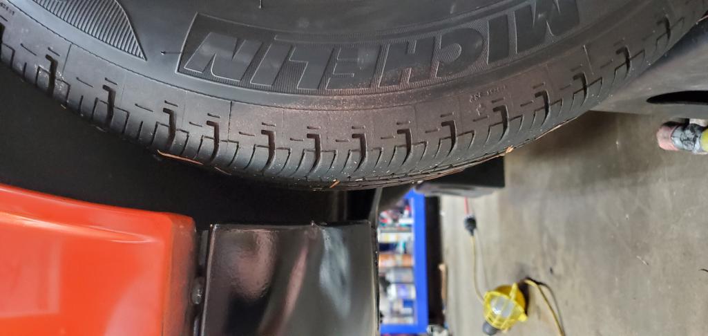

tvdinnerbythepool   This car is like the most frustrating game of Whac...   Jan 5 2020, 06:44 PM
DickSteinkamp   What do you guys think? Am I missing anything e...   Jan 5 2020, 07:44 PM
ndfrigi   with 195x60 tires, it should not be that close to ...   Jan 5 2020, 07:23 PM
mepstein   It’s the Rivs. That’s a wide tire for them but...   Jan 5 2020, 07:41 PM
tvdinnerbythepool   Here is a side view pic. The ride height is too hi...   Jan 5 2020, 08:14 PM
ndfrigi   Here is a side view pic. The ride height is too h...   Jan 5 2020, 09:37 PM
raynekat   Here is a side view pic. The ride height is too ...   Jan 5 2020, 09:45 PM

rhodyguy   Have you settled the suspension? You need to roll ...   Jan 5 2020, 08:19 PM
tvdinnerbythepool   Have you settled the suspension? You need to roll...   Jan 5 2020, 08:25 PM
mepstein   The type of wheel won’t make a difference. They ...   Jan 5 2020, 08:25 PM
burton73   The type of wheel won’t make a difference. They...   Jan 5 2020, 09:14 PM
