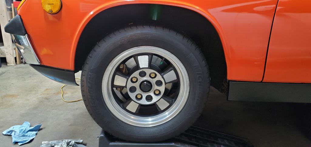

Here is a side view pic. The ride height is too high and the back of the car is on jack stands making it look even worse, however, I don't think this is my issue. I believe it is the stock valance.
I'm also now thinking the formula for front ride height is not working with the rivieras...ugh

QUOTE(tvdinnerbythepool @ Jan 5 2020, 06:14 PM) *
maybe too much negative caster or something wrong with the suspension that makes the center wheel towards the front since the picture show there is a lot of space at the rear side.
and the lower valance seems bent that makes it leaning inside or that was cause by the tire rubbing to the valance?
