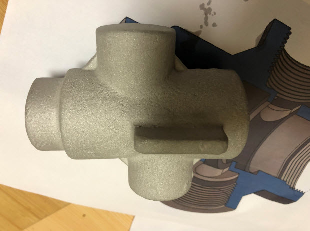

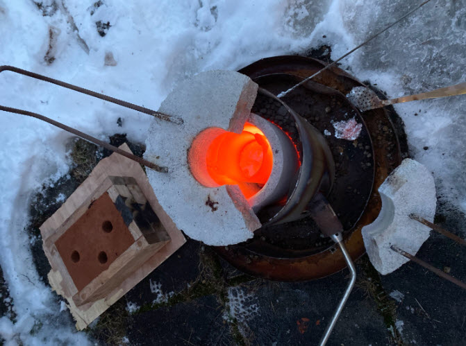

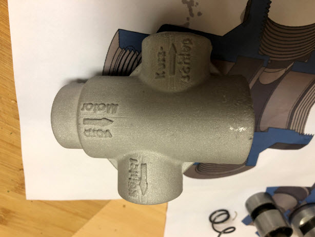

The definitive highlight this Christmas was first shot at the sandcasting of the GT oil thermostate housing. There was a little bit of sinking around the mounting ear, but we will sort this out next run.
Melting the snow outside my very skilled casting connections garage (IMG:style_emoticons/default/popcorn[1].gif)
casting pre meachining
Other side of part with sunken area. Machining plans on the paper under the part
Have a nice weekend (IMG:style_emoticons/default/beerchug.gif)
