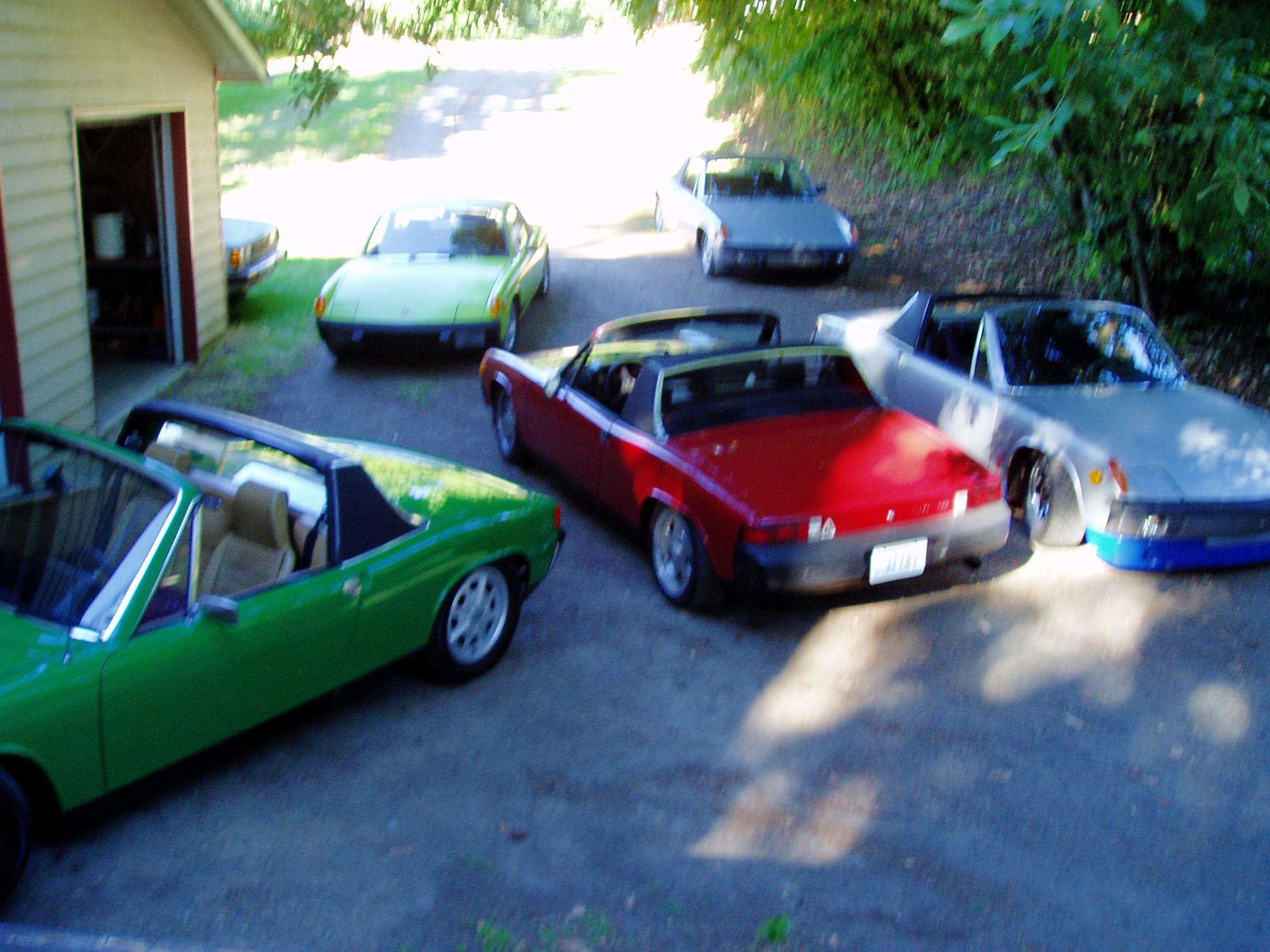

First off, I don't think the color is Malaga red. You have more of a guards red. see my attachment...
