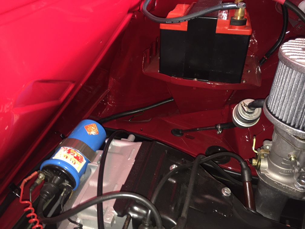

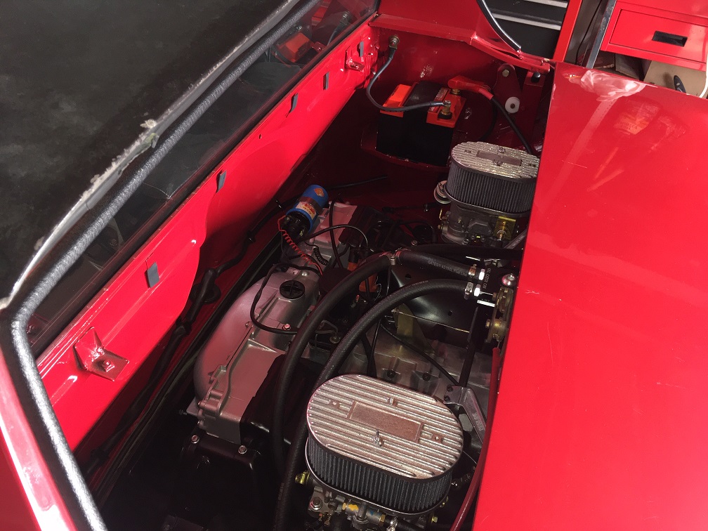

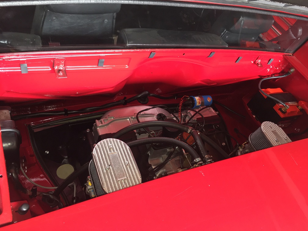

Here's are photos of the finished engine bay, it's repainted with the Malaga Red specs that I gave to the paint shop. The car is running great.
