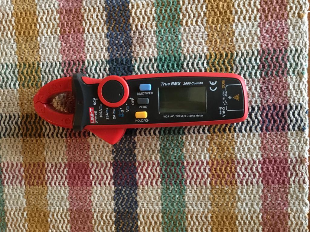

Here's the current clamp I purchased.
Took quite awhile to find the right one as most on eBay, Harbor Freight, etc only do AC current.
I wanted DC current.
This Uni-T UT210E from China (oh why oh why can't Americans make something like this for a decent price?).
It was $62.48 delivered.
How can you go wrong? (IMG:style_emoticons/default/blink.gif)
The specs that I was most interested in:
DC current
2.000A with 1mA resolution and +/- 2%+8 accuracy
20.00A with 10mA resolution and +/- 2%+3 accuracy
100.0A with 100mA resolution and +/- 2%+3 accuracy
So the selector can choose between 3 ranges for current.
https://www.ebay.com/itm/New-Uni-T-B4Q094-U...353.m2749.l2649
Guess the next question is where exactly would I measure for current draw?
On one of the main cables coming out of the positive terminal from the battery?

raynekat   Here's the current clamp I purchased. Took qui...   Jan 16 2020, 02:28 PM
Superhawk996   Guess the next question is where exactly would ...   Jan 16 2020, 06:09 PM
