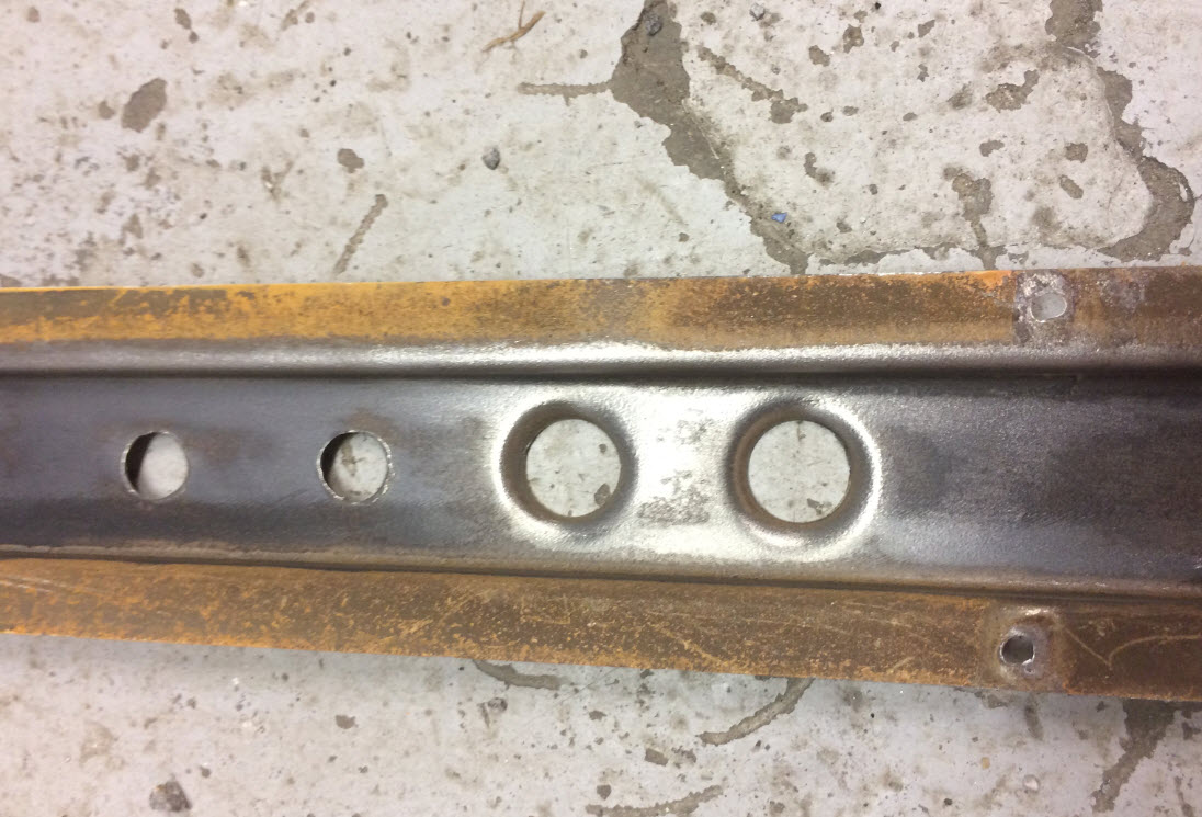

A quick update before the weekend. Here are some pictures of the fabrication of the GT-engine lid. I initially bought the mesh typically used in period, but thought it was a bit rough, so I made my own iterpretation based on the original lid and mesh.
The idea was to merge two lids into one.
Also had to add some holes in the crossmember
The near finished product. some battle scars in the mesh..
Good thing I had some extra mesh.
And some precision mig welding (IMG:style_emoticons/default/welder.gif)
More or less finished.
