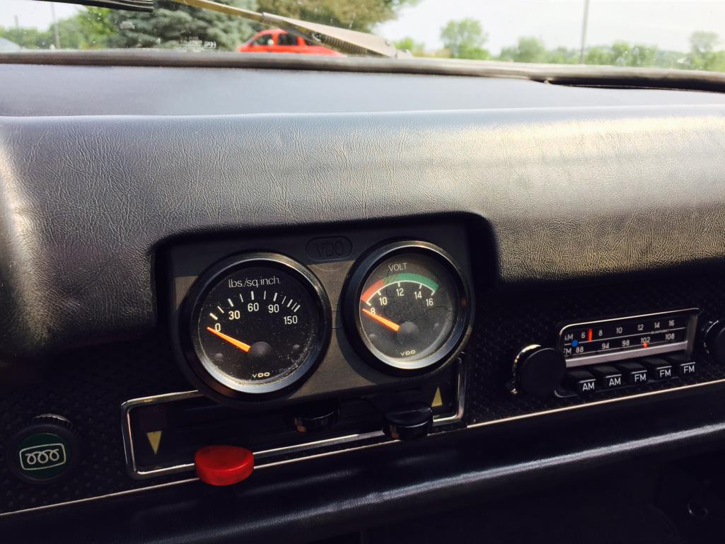

Just curious what the typical volt meter reading is:
1) when you're sitting at the stoplight
2) cruising down the boulevard at 3-4000 rpm
Trying to see if I'm seeing typical or low readings
Thanks
I just recently noted a low charging issue that I believe came down to an alternator/voltage regulator mismatch.
I was using a Bosch VR with my Motorola alternator.
Now I've switched to a Marchal VR and the charging voltages look better.
About 13.75 volts while cruising.

Usually reads about 13.5 volts while driving. I don’t know how accurate the VDO voltmeter is in comparison to the plug in ones (but I do use one in the cigarette lighter socket on my 911.

I measured the VDO voltmeter in my car and found the voltmeter to be within 0.1V in the 8 to 16V range. The real error as we all know is connecting the voltmeter somewhere in the 914 wire loom where voltage drops are common.
