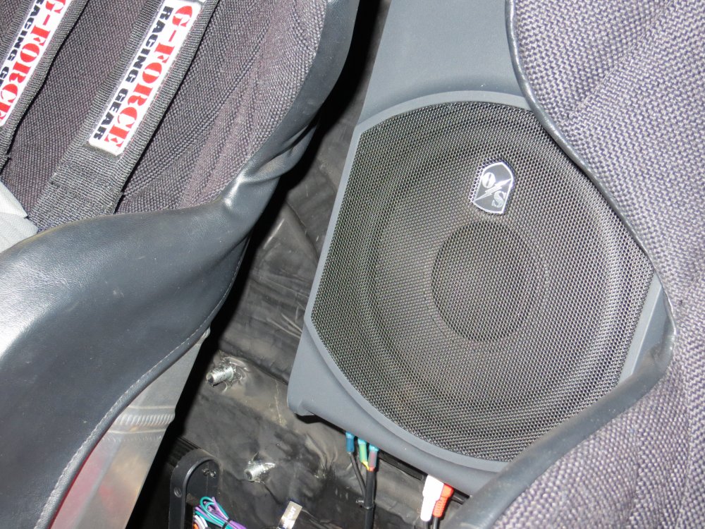

A few years ago, when @cupomeat and I ran one lap together, I installed a 600 watt Bluetooth amp so we could have some tunes on the road wirelessly routed from our phones. While the theory was good, it's still loud as $%#@ in the car at speed and there really was no bass.
With a little research, we came up with the Sound Ordnance B-8PTD which is an 8", 125 watt, self powered amp. This neatly and conveniently connected into the Bluetooth amp's RCA outputs.
The next trick was mounting since the car is set up for track duty with a roll cage and containment seats bolted pretty close to the floor. It couldn't go on the passenger footwell because there are oil lines there and it's already cramped for the passenger. It couldn't go behind either seat because they are all the way back (I'm 6'-3"). It could fit between the seats like the Ford GT because I have no firewall pad.
I disassembled the amp and put bolts through the baseplate which were nutted on the outside, basically making each of them a stud so that I could bolt it through the firewall with nylock nuts.
On a side note, I learned that that the Sound Ordnance box is sealed when I didn't seal up two holes that I had placed in the wrong location on the backplate. The result was a hissing noise at every bass hit!
While this isn't a huge sub, it is more than enough to fill in the missing bass in the small 914 cabin.
