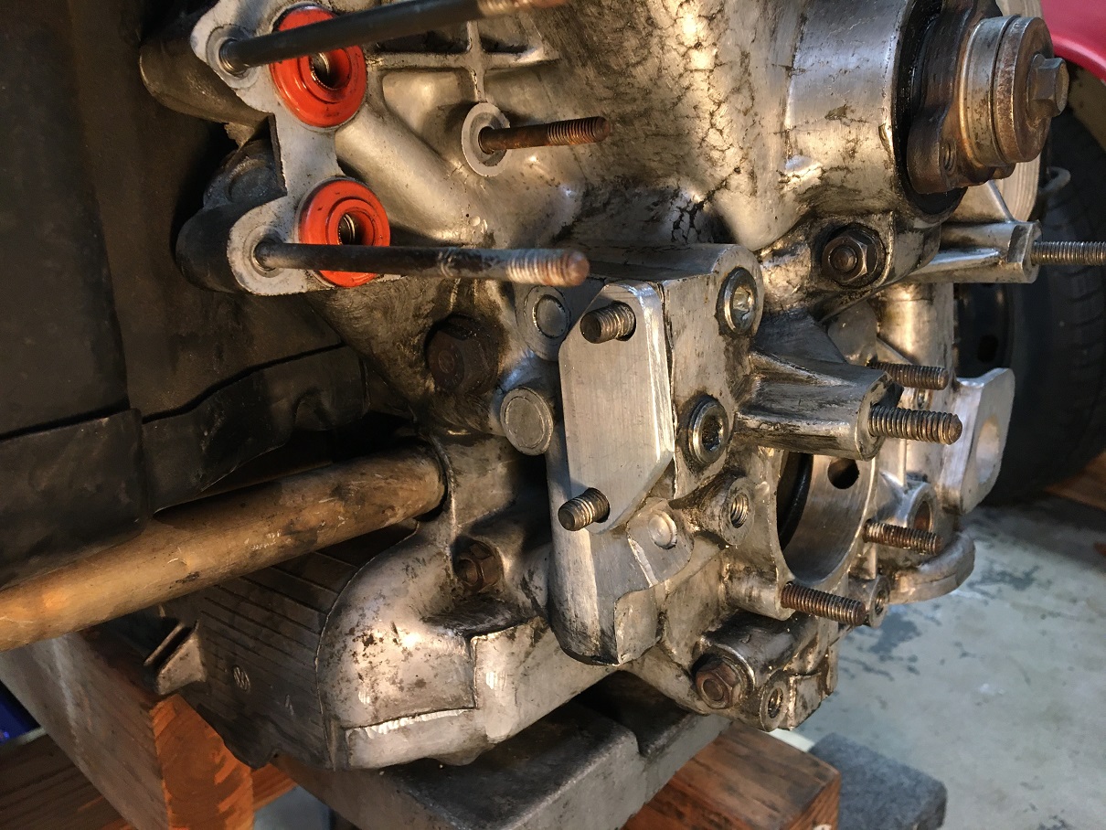

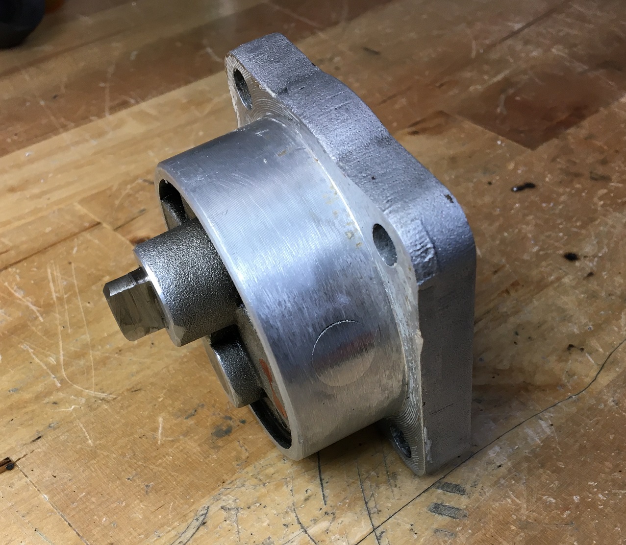

First, Friday ( I get every second Friday off (IMG:style_emoticons/default/pray.gif) ) I went to EMW and got my oil pump blocked off. They pressed a slug in the hole. It felt like it was protruding a little over the pump diameter so I gently filed it down and checked the diameter once done. It is now ready for the re-installation. I'm hoping to get a cast iron full flow pump cover with pressure relief from Gene Berg maybe tomorrow if they are open.
Then I fabricated a block off plate for the oil filter mount that I am removing. I used a 1/4" aluminum plate and my trusted hack saw, vise, file and HF drill... (IMG:style_emoticons/default/smash.gif)

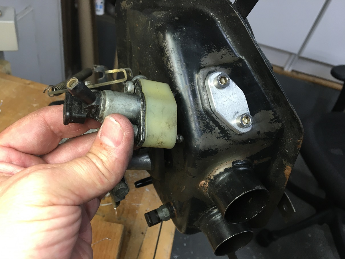

While I was at it making blanks, I also did one for the plenum as I will not be using the stock Cold Start Valve (CSV) anymore.
Next steps ahead, oil pump and cover installation, and Dub Shop crank trigger setup. (IMG:style_emoticons/default/smile.gif) (IMG:style_emoticons/default/beer3.gif)

QUOTE(Montreal914 @ Jan 19 2020, 07:27 PM) *
Not sure what your your plan is for the idle valve pluming, but that plastic block under the cold start injector is the port for the stock aux air regulator. May want to leave it and put your block off plate on top of it.
