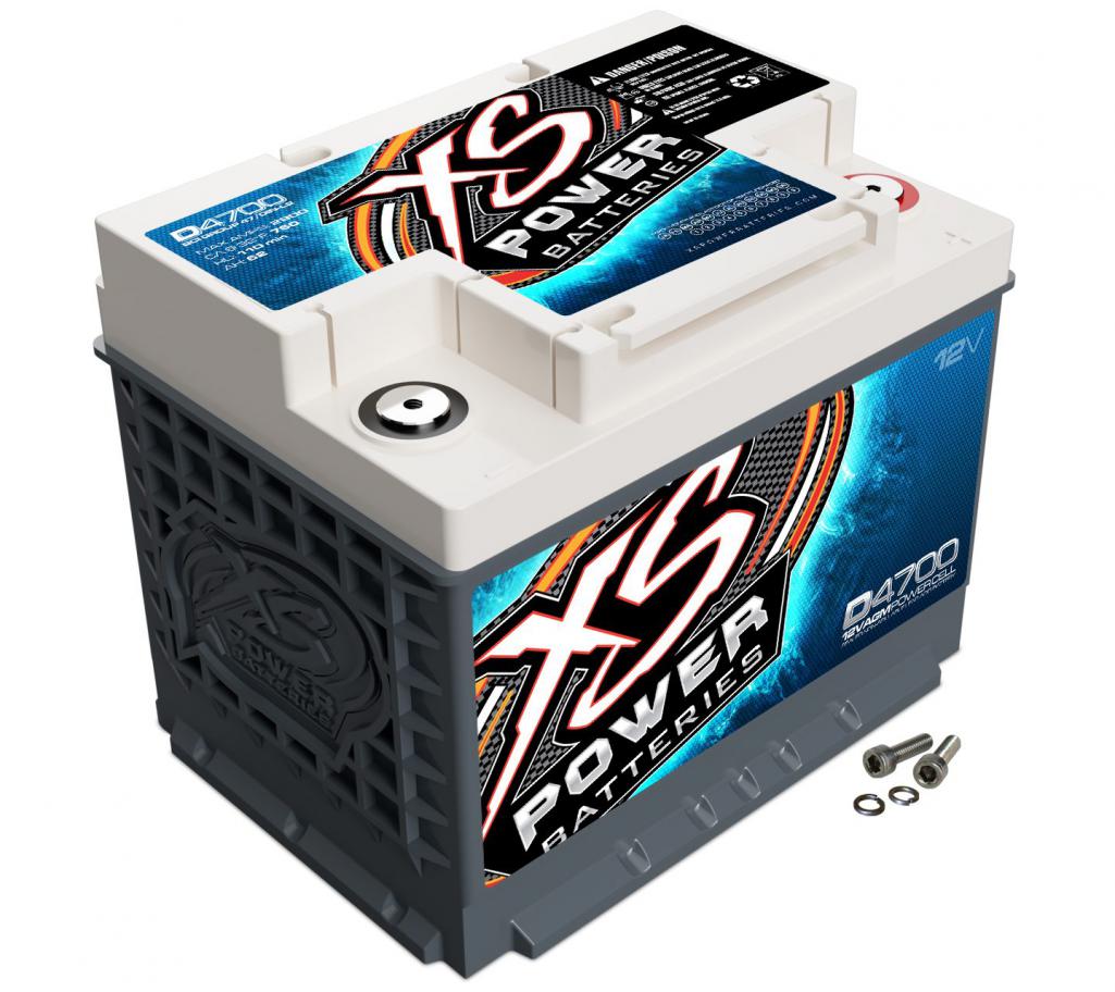

Looking at one of these AGM batteries as a replacement for my Lithium-Ion.
Looks like it has plenty of AmpHr: 62.
Weight is a bummer (41 lbs), but that's what a daily driver battery weighs it seems.
And not inexpensive as automotive batteries go.
Terminals appear to be in the right locations....a big plus.
Will do a bit more research on them.
There is an Odyssey that would fit and has 55 Amp-Hr but the terminals are wrong.
Here are the specs:
D4700
MSRP: $321.99
12V BCI Group 47 AGM Battery, Max Amps 2,900A, CA: 760A, Ah: 62, 2000W / 3000W
Weight Lbs. – 41.19
Weight Kgs. – 19.14
Length – 9.49 in
Height – 7.48 in
Width – 6.93 in
MAX Amps – 2900
CA – 760A
RC - 110
Ah - 62
M6 Terminal Hardware Included
3 Year Warranty
