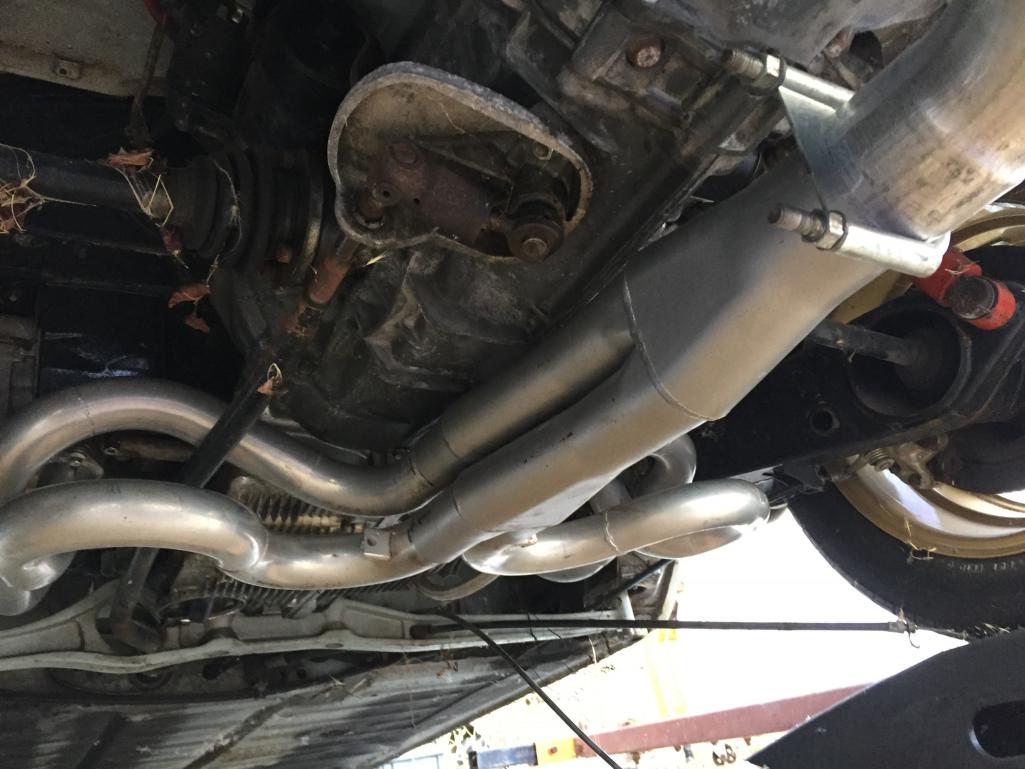

Moving right along I have the exhaust installed (roughly).

B2524   Thermal expansion? Say what? I used a muffler hang...   Feb 1 2020, 06:48 PM
B2524   The angle iron is from an old bed frame. The hange...   Feb 1 2020, 06:53 PM

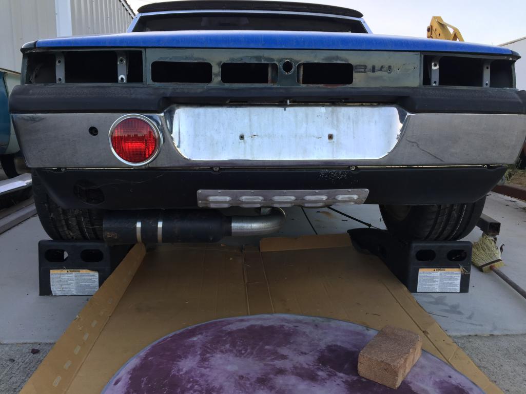

B2524   I was at a swap meet and found that rear valance. ...   Feb 1 2020, 07:31 PM
B2524   Oh yeah I forgot to mention. They ran a sport muff...   Feb 1 2020, 07:36 PM
