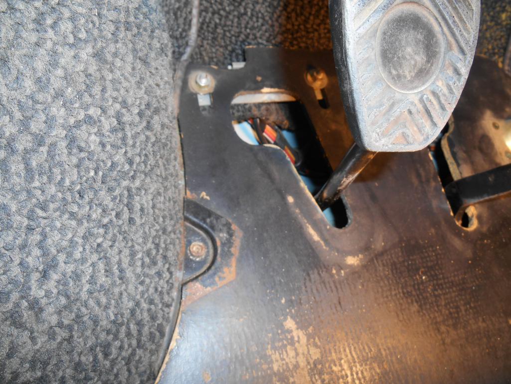

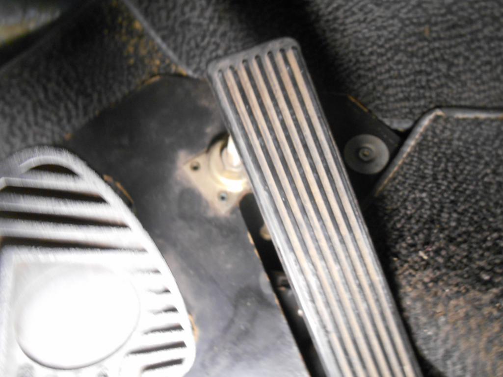

I did look at it today when I was down there checking the indicator lights for the fan/defrost assembly 3 are now working but the last right bottom indicator is not, tried new bulbs and pulling out the tiny wire leads on the bulbs but it appears that the one socket might be bad. Anyway back to the brake lights staying on when the key is on, I took these pictures and it looks like 4 nuts need to come off and then I think the board will come off around the gas pedal to get to the brake light switch. First pictures show 3 nuts left and center, second pic shows one nut right of the gas pedal. Does that look right probably just these 4 nuts ??
brcacti brake lights on all the time Feb 1 2020, 01:56 PM
ndfrigi
My mechanic said my brake lights are on all the t... Feb 1 2020, 02:03 PM
Superhawk996 :agree:
While you're down there, check for b... Feb 1 2020, 02:57 PM
ndfrigi to remove the pedal board? just the 2 allen bolts ... Feb 1 2020, 04:26 PM
ndfrigi
to remove the pedal board? just the 2 allen bolts... Feb 1 2020, 04:31 PM
rgalla9146 Take the pedal pads offf too.
Center console ? ... Feb 1 2020, 06:32 PM
brcacti brake light switch FIXED, THANKS SO MUCH to the gr... Feb 7 2020, 04:03 PM
914Sixer 914Rubber has them Feb 7 2020, 04:08 PM
Mikey914 4th one down on the left. Also linked the search s... Feb 8 2020, 12:59 AM![]() ![]() |
