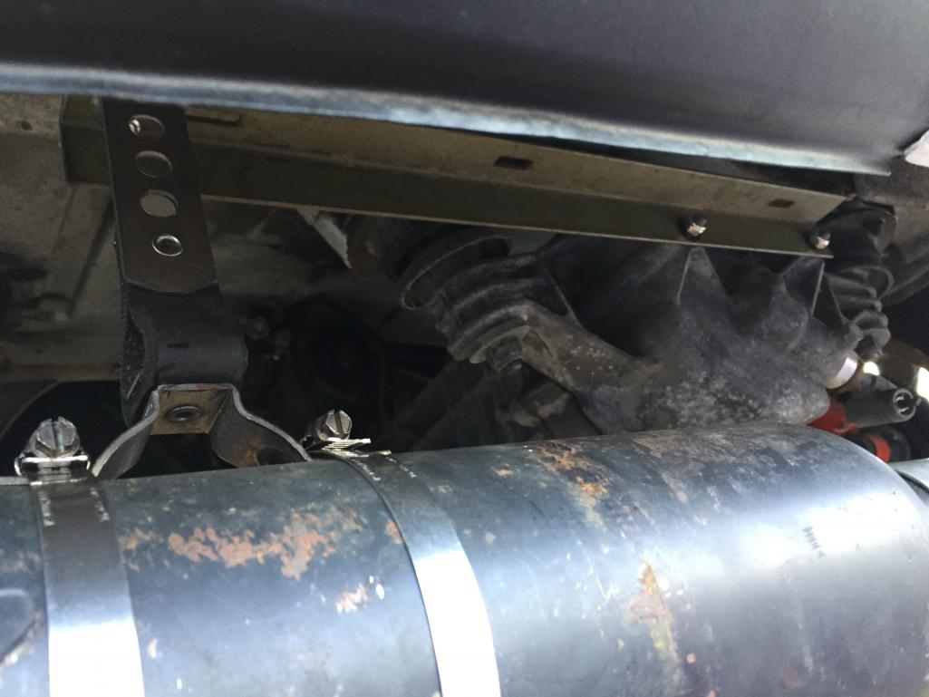

post Feb 1 2020, 06:48 PM
It's a sickness.
Posts: 72
Joined: 12-November 11
From: Outside Paso Robles CA
Member No.: 13,776
Thermal expansion?
Say what?
I used a muffler hanger.
