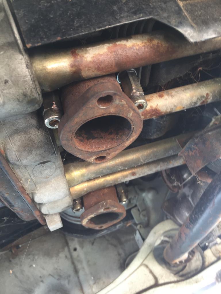

B2524   Moving right along I have the exhaust installed (r...   Feb 1 2020, 12:00 PM
barefoot   Moving right along I have the exhaust installed (...   Feb 1 2020, 01:01 PM
Daryl32   OK you have my attention!!!!!...   Feb 1 2020, 01:39 PM
Daryl32   I LOVE the steel flairs!!! By the way...   Feb 1 2020, 01:40 PM
B2524   Thermal expansion? Say what? I used a muffler hang...   Feb 1 2020, 06:48 PM
B2524   The angle iron is from an old bed frame. The hange...   Feb 1 2020, 06:53 PM

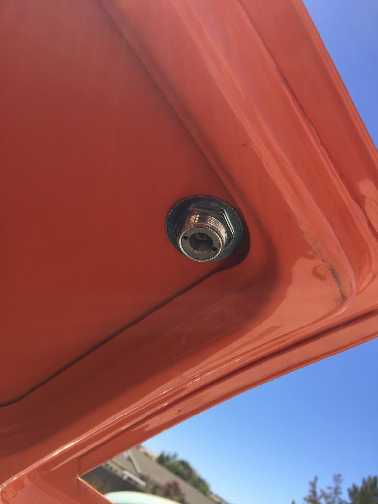

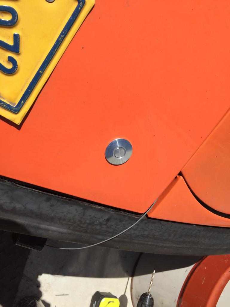

B2524   One more thing I added to the build. I have a spa...   Feb 2 2020, 12:12 PM
sixnotfour   how old those Dunlops ??,,,, I had a nos pair I p...   Feb 2 2020, 03:53 PM
B2524   The rears are American Racing. They will build th...   Feb 2 2020, 05:00 PM
