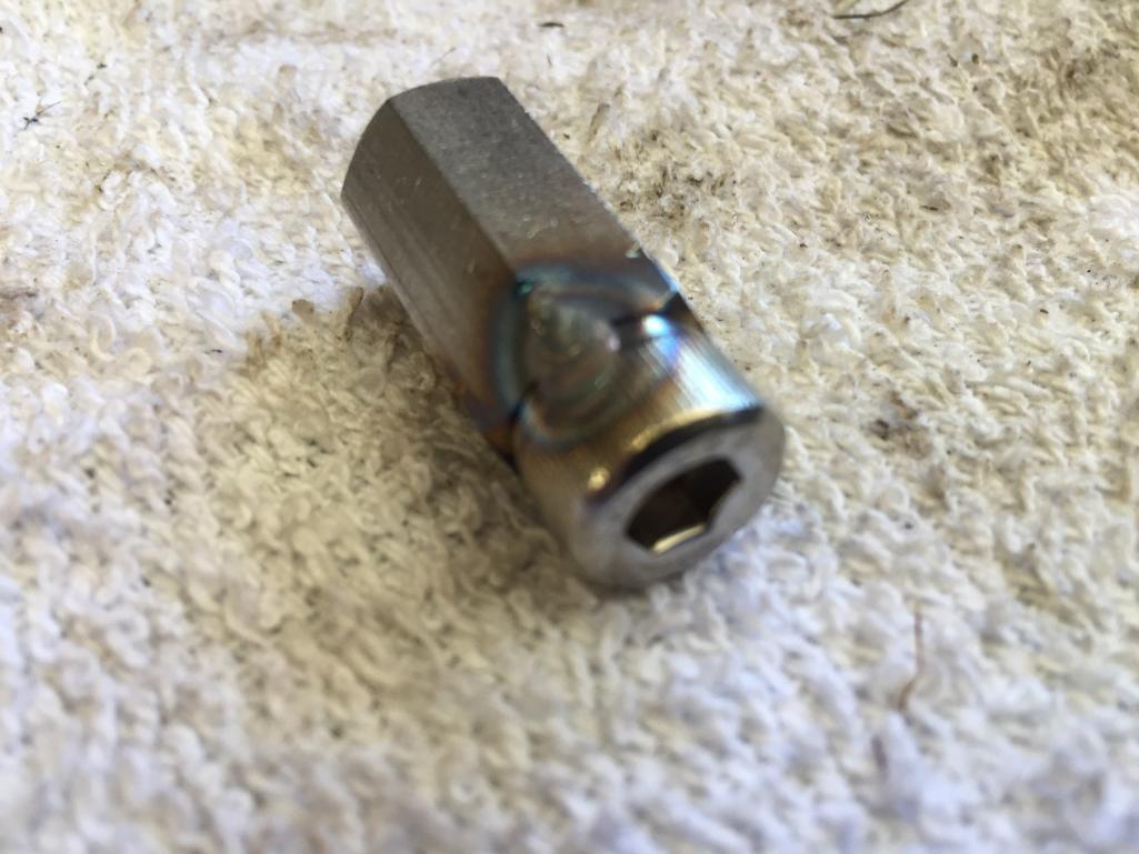

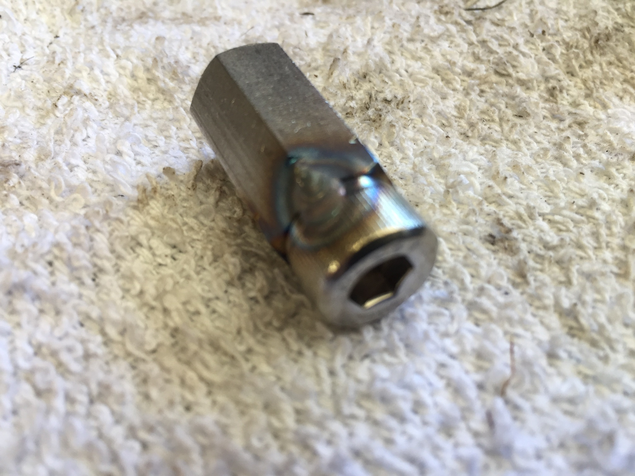

B2524   Here are more things I’ve done.   Feb 1 2020, 07:05 PM
B2524   This one didn’t load.   Feb 1 2020, 07:07 PM
B2524   Guess I missed two others Here is a learning expe...   Feb 1 2020, 07:17 PM
