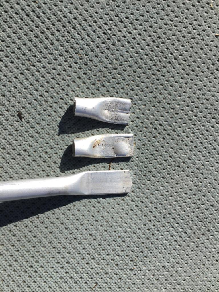

Here is a learning experience. I wanted to make aluminum struts.
So I bought some tubing from Home Depot.
The top piece is where I just crushed it in a vise. As you can see it cracked.
So I used a butane torch to heat it up on the second attempt shown in the middle. The bump is from a hole in the face I used to crush it.
The problem now is to make a smooth transition from the round tube to the flat end. So I took a piece of aluminum and put a radius on the edge. I used it as a jaw when I crushed the bottom piece.
