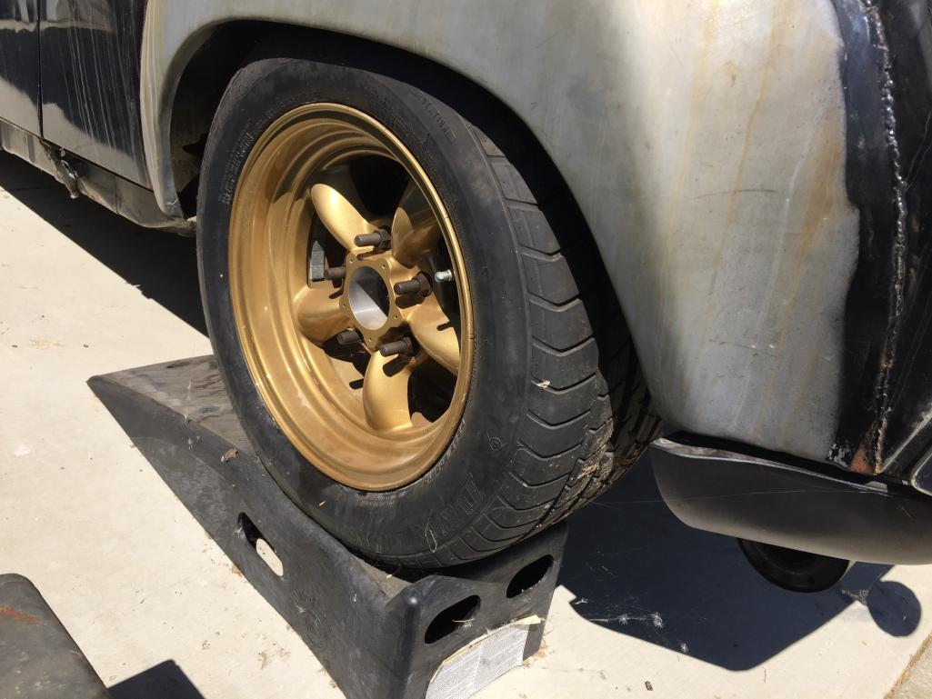

I was at a swap meet and found that rear valance. Which the trained eye will notice is from a 914-6. It came off an old GT that was raced back in the day. The cool thing about it is they flared it in metal.
I need to spend some time fitting it to the car but this gives you an idea. It was not show car quality but it works for me. I had it powder coated in a semi flat black. BTW the Americans are late wheels I had made up. The inner is cast but the outer is spun. They are very lightweight and you can get them in various widths and offsets. The rears are 9’s with 5.75 or 6 inch backspace. I can’t remember but I they were 6..
