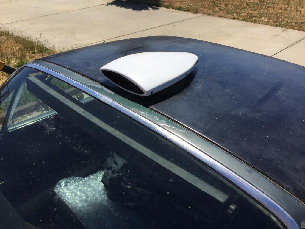

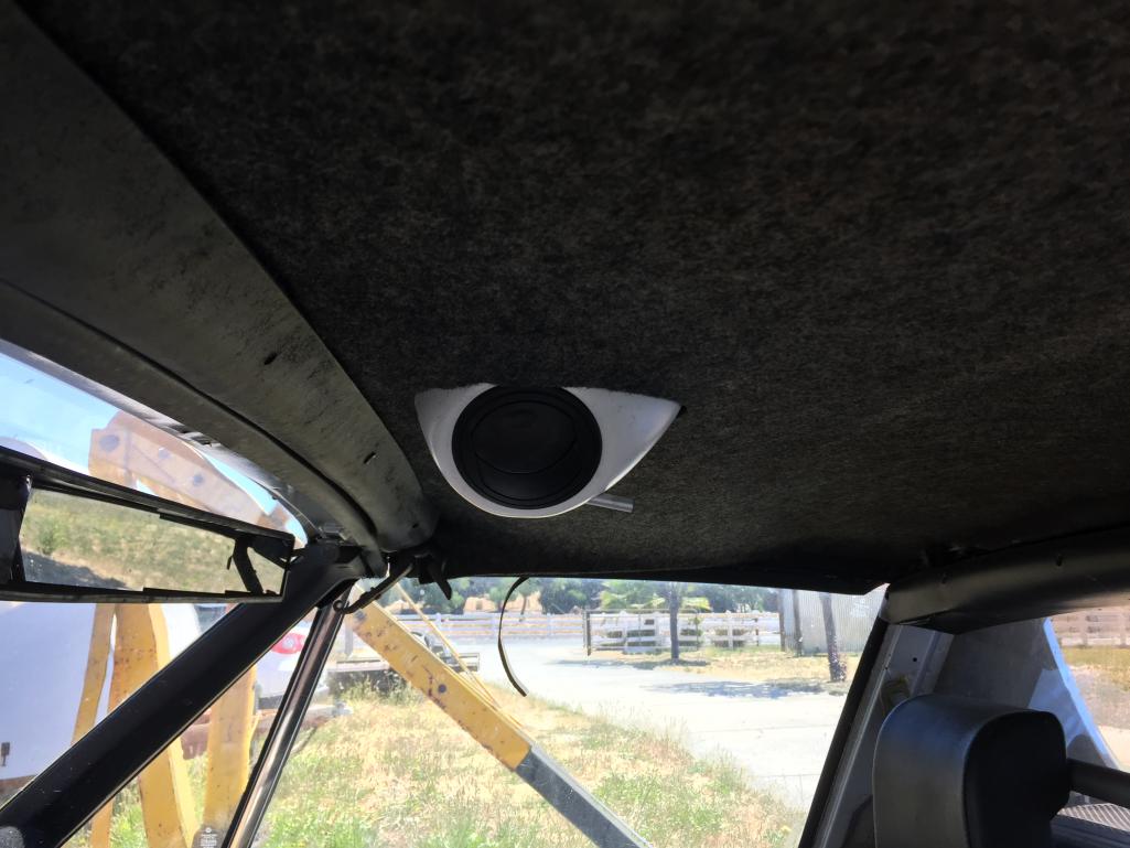

One more thing I added to the build. I have a spare roof so I thought I would play with this one and try to add some ventilation.
