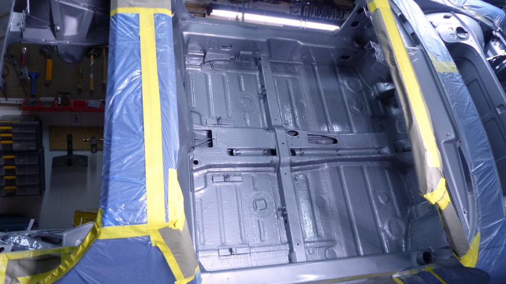

914 Guru ![]() ![]() ![]() ![]() ![]() Group: Members Posts: 5,269 Joined: 17-February 17 From: Montana Member No.: 20,845 Region Association: Rocky Mountains
I have not tried this. But since the dynamat is a tar type bonded to an aluminum backing, could you paint over the dynamat ? sanding it and treating it as an aluminum panel? I have the Dynamat all over the interior under the carpet and backpad. nothing on the engine side though. That is exactly what I did. Not Fat Mat, but Noico. Same thing just less expensive. I etched the aluminum face with phosporic acid then sprayed with reduced epoxy primer and then top coat. The result looks very close to the factory tar. You can read the whole process here: http://www.914world.com/bbs2/index.php?s=&...t&p=2659673 (IMG:http://www.914world.com/bbs2/uploads/post-20845-1542334603_thumb.jpg) |
