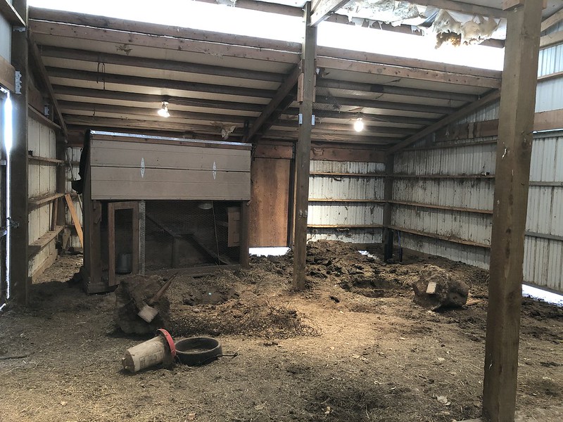

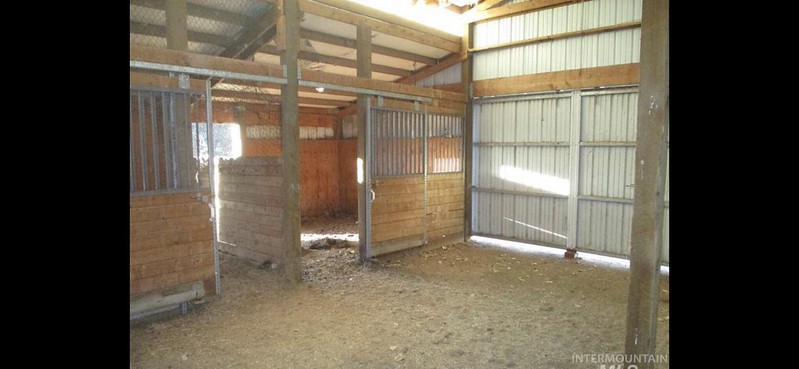

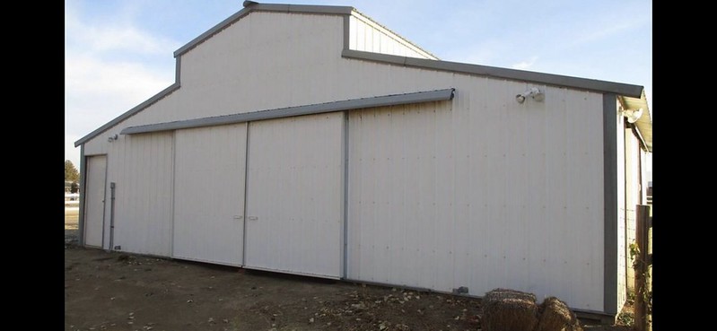

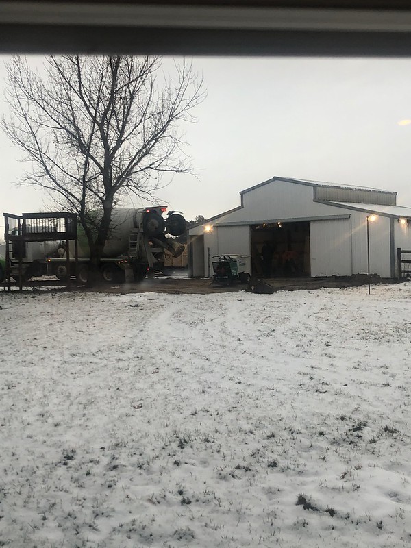

Well, it's been a while since I've updated this conversion thread. But, I have a good excuse. I've been hating my current garage workspace for a while. Its been a huge source of fighting between my wife and me over the years. She gets tired of my "crap" crowding her parking spot in the garage. And, now that my son has the welding and fabrication bug, the problem has compounded. So, back in October I started a search and found a solution to the problem:
(IMG:http://www.914world.com/bbs2/uploads_offsite/live.staticflickr.com-22225-1581029099.1.jpg)
I found a barn. Sure there was this annoyance of it sitting on a 2.4 acre lot, and it required selling and buying a house. But these are just small details right? After lots and lots of begging (and a commitment to install a new kitchen and flooring in the process), my wife agreed. (IMG:style_emoticons/default/aktion035.gif)
So in between house projects, I've gutted the barn, roughed in some plumbing for a sink and toilet, and had a concrete floor put in. It should be a MUCH better space for these types of projects. The problem is that all work on the 914 has come to a screeching halt. BUT, hopefully soon I'll have things put back together in the new place.

It's wired for 220, but needs a little insulation and heat before its ready to see any action. I'm still debating on whether to run gas from the house (about 100 feet) or just get a pellet stove with a thermostat. Either way, I'm super excited and have serious motivation to finish my home remodel projects. (IMG:style_emoticons/default/smile.gif)
