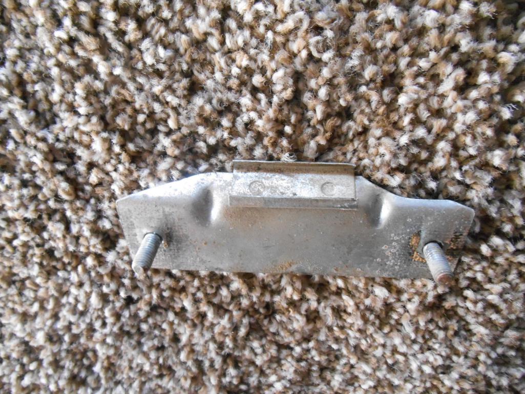

brake light switch FIXED, THANKS SO MUCH to the group who helped and the doc with very helpful information on this. The actuator WAS not aligned to the washer, not it is and now the brake lights work normally. These forums, this one and pelican are SO HELPFUL, saving me stress, work and money. One more question the clutch bottoming plate was missing the rubber piece and I looked but could not find it down there. Can I buy this piece without buying the whole plate see picture.

914Sixer 914Rubber has them Feb 7 2020, 04:08 PM
Mikey914 4th one down on the left. Also linked the search s... Feb 8 2020, 12:59 AM![]() ![]() |
