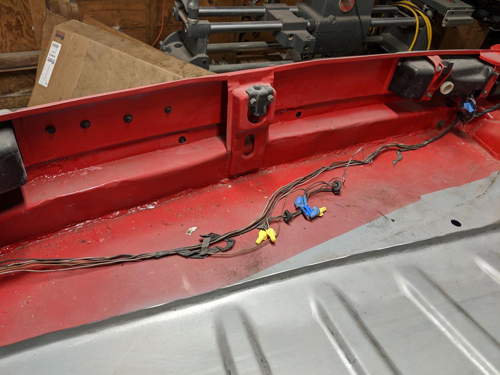

Rear trunk, back is fairly lumpy and has a lot of bondo. I have the restoration design floor pan and a member here is sending me a rear section that I will replace at the same time.
(IMG:http://www.914world.com/bbs2/uploads_offsite/i.imgur.com-23821-1581114467.1.jpg)

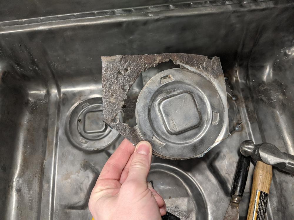

Front trunk rust hole:
(IMG:http://www.914world.com/bbs2/uploads_offsite/i.imgur.com-23821-1581114467.2.jpg)

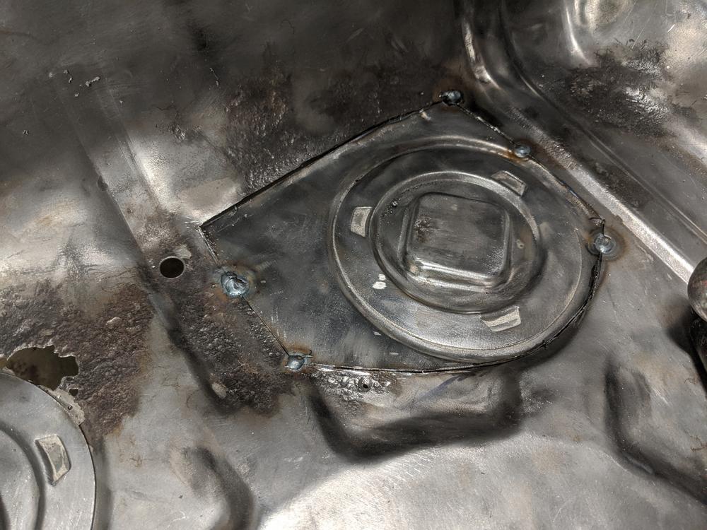

Replacement piece being welded into place:
(IMG:http://www.914world.com/bbs2/uploads_offsite/i.imgur.com-23821-1581114467.3.jpg)
